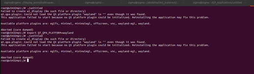

I have built the st-example-image-qt using openstlinux(Openstlinux-5.15-yocto-kirkstone-mp1-v23.07.26)  to run a qt application for stm32mp157f-dk2 board.I could run the application the application successfully.
It would be very helpful to move forward with my further development, if i could get the clarifications regarding the below mentioned points :
1.How to enable window manager support in the example image that i am working with.
2.How to implement  debugging of  QT Application using remote gdb server.
3.How to display on application on DSI and HDMI simultaneously.

Hello @Srikanth1 ,
1) If you use EGLFS distro as explained in this chapter, you will not be able to have a window manager. This is the principe of EGLFS, it has no windowing system. On the other hand, it is more performant.
To get a window manager with Qt, you should use qtwayland as explained in this chapter. Be careful, if you are not in fullscreen for your application, you will have more composition to process on the rendering screen.
2) ST provides a way to bring Qt into its own distribution, but all that concerns the Qt developing process is not part of ST anymore. I invite you to get the necessary information from Qt website such as :
3) It is not something possible on stm32mp157f-dk2. The LTDC can accept only one pixel-clock and timing configuration, so you have to chose between HDMI or DSI output.

1.I have changed the distribution to weston and built st-example-image-qtwayland and implemented the same QT application executable file but it gives me the error mentioned in the attached screenshot.
2. I would refer it the links You have shared.

@Srikanth1 ,
Please try to launch your Qt application with a such script :
# !/bin/sh
export QSG_INFO=1
export QML2_IMPORT_PATH=~/imports/
export PATH=/usr/local/qt5-install/bin/:/usr/local/apitrace/bin:$PATH
export QT_QPA_PLATFORM=wayland
#Execute the Qt program
export XDG_RUNTIME_SESSION=wayland; export XDG_RUNTIME_DIR=/run/user/`id -u weston`; export WAYLAND_DISPLAY=wayland-1; cd <PATH_APPLICATION> && ./<APPLICATION>
Replace <PATH_APPLICATION> and <APPLICATION> by your own information.
Kind regards,
Erwan.
