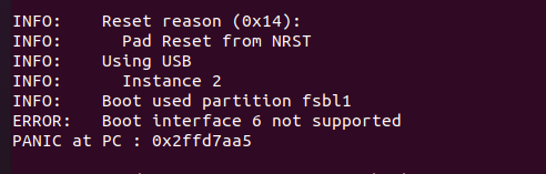

The terminal printing information is as follows.
This TF-A will start properly in EMMC.

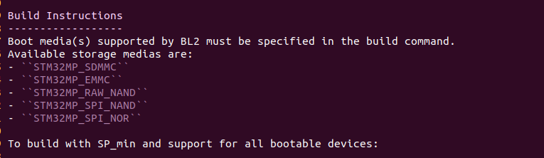

In the docs/plat/stm32mp1.rst file, I saw that USB is not supported. May I ask how to modify it so that it can be burned via USB

Hi @文�?� �?​
This is a known issue we have recently discovered internally also.
I come back to you shortly.
Olivier
Olivier GALLIEN
Bernard PUEL
In the developer package, the Makefile.sdk for tf-a was not well generated and it needs revision for the "serialboot" build.
A new Makefile.sdk will be delivered in this post that will solve this issue.
