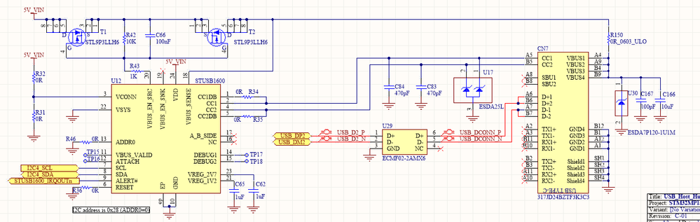

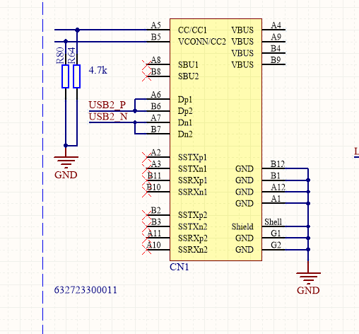

I have custom stm32mp1 board and when running it as USB mass storage in U-Boot (ums 0 mmc 0), the USB driver is not detected nor by Linux nor by Windows. I am also attaching shematc comparison of eval-board VS my custom board. Also the USB-ORG is working in Engineering mode as DFU device - so I am guessing the soldering and USB pinouts are correct.
0693W00000HprgoQAB.pngPic.1. Custom board schematics of USB-OTG0693W00000HprgZQAR.png2.Pic. Eval-board schematic of USB-OTG.

Hi @Arnas Celkys​ ,
I recommend to check your DT and set OTG node according to https://wiki.st.com/stm32mpu/wiki/How_to_configure_U-Boot_for_your_board#USB_OTG_node
With ecosystem V3.x, in order to force VBUS and ID pins to be ignored, it should have:
 &usbotg_hs {
 	u-boot,force-b-session-valid;
 	u-boot,force-vbus-detection;
 	dr_mode = "peripheral";
Btw, the pull-down Rd resistor on CC lines should be 5.1k (but I think 4.7k might not explain why PC did not detect your device as 10% tolerance is allowed)
Regards.
