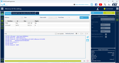

Maybe there's another problem with this board ... it looks like BOOT0 is pulled low and BOOT1 and BOOT2 are pulled high which should mean serial boot mode, but what I'm seeing in STM32CubeProgrammer is this:
ChatGPT says I should be seeing STM32CubeProgrammer downloading a small loader into the system's RAM automatically, something like this:
Downloading built-in loader...
Loader successfully executed.
and that since I'm seeing DFU mode, that indicates my STM32 isn't actually in serial boot mode.  Is it right?
Hi @cbcooper
"serial boot" mean UART or USB DFU (USB is a serial device).
https://wiki.st.com/stm32mpu/wiki/STM32_MPU_ROM_code_overview#Serial_boot

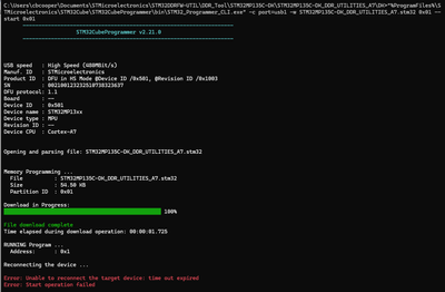

  • run following CubeProg on command line (might need to adapt to your environment)
    • "%ProgramFiles%\STMicroelectronics\STM32Cube\STM32CubeProgrammer\bin\STM32_Programmer_CLI.exe" -c port=usb1 -w STM32MP135C-DK_DDR_UTILITIES_A7.stm32 0x01 --start 0x01

Alas no UART, only USB.  PD6 goes to RMII_REFCK and PD8 is not connected at all.
Running your command line on an un-modified STM32MP135C-DK_DDR_UTILITIES_A7.stm32 seemed to do something at least:
