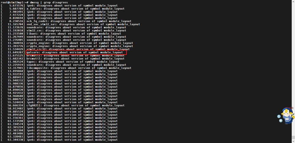

This is a problem that has bothered me for months.
I hope someboby could give me some help.
Firstly I use STM32Programmer to flash the STM32MP157F-DK2, it runs really fun.
After I rebuild the kernel V3.1.0 followed by Wiki and use "scp arch/arm/boot/uImage root@192.168.7.1:/boot" many modules can't be probed successfully.
The complete boot log is in boot1.txt.
So I have to compile the modules and use "scp -r install_artifact/lib/modules/* root@192.168.7.1:/lib/modules" to replace the original.There're still some problems.
The complete boot log is in boot2.txt.
Only the following problems
What's the galcore and how to solve it?
Now the board can't launch the default applications automatically and I can't clicke to started them manually.

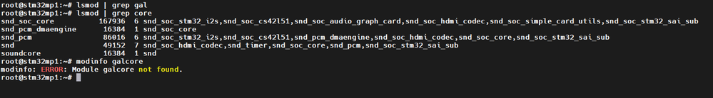

Hi @mteaching ,
galcore.ko is the driver for the GPU.
Error : galcore: disagrees about version of symbol module_layout
Highlight that the module looks to no been built with same version of kernel installed on the board.
Does all your environnement consistent with DV3.1 ?
Means Starter originally load on board, SDK and Kernel sources ?
What gives modinfo galcore on the target ?

I'm sorry I didn't reply in time due to my business trip.I'm sure my environnement consistents with DV3.1 only.I build the kernel by following the tutorial on the wiki step by step.Can I fix it by using "make menuconfig"?Some people have the same problems(Since V2.0) as me.:grimacing_face:
"modinfo galcore" shows this:
see this:https://community.st.com/s/question/0D53W00000JiZmuSAF/stm32mp157caa3-galcoreko

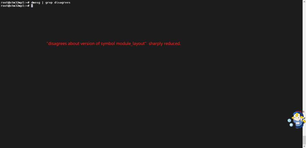

To summarize:
All the errors of "disagrees about version of symbol module_layout" disappeared when the copy of the modules is correctly done, BUT, "Time out check load galcore module expired" still exists.
After several tries, I finally was able to reproduce the problem on my MP157C-DK2 board with the Developer Package v3.1 (Linux 5.10.61) like your log.

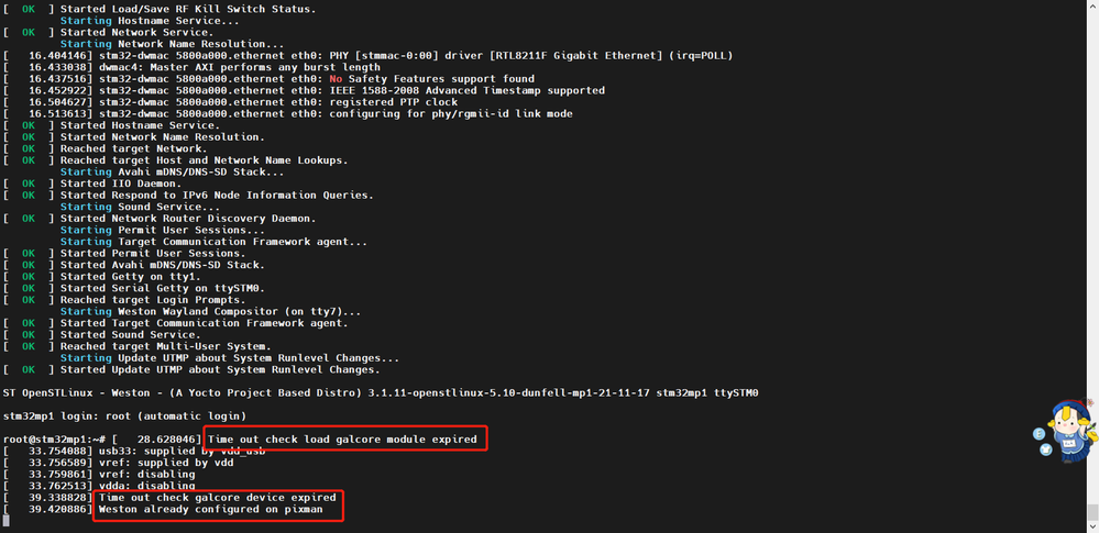

The fist error of timeout doesn't seem to disturb the behavior of the screen:
root@stm32mp1:~# [ 44.510073] Time out check load galcore module expiredBut when the second errors occur:
root@stm32mp1:~# [ 56.109899] Time out check galcore device expired
[ 56.182392] Weston already configured on pixmanThe screen goes black during 1-2 seconds. This doesn't happens with the Starter Package, so it looks like the bug that you describe.

Thank you for your reply,I succeed after some difficulties.
Firstly I build the galcore.ko directly, after I did the steps you said, I did get the module "galcore.ko" successfully,and I make the step 3 you said. But after the step Installation of module, it add a diectory called something like 5.10.61-g1620493e133f-dirty with warnnings the directory doesn't exist.
Error "Time out check load galcore module expired" persists after copying, even the network can't be used.

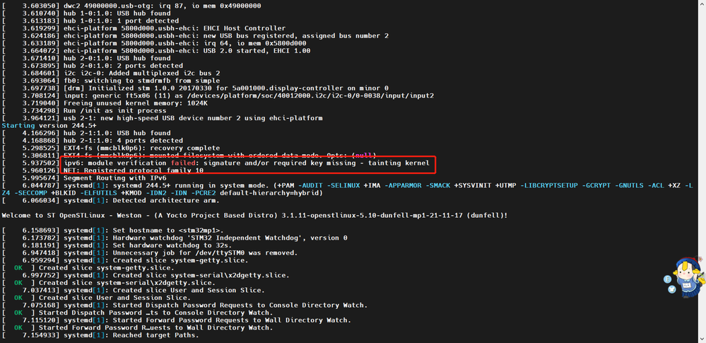

Now only one error exist but the net work normally:
[ 6.279871] ipv6: module verification failed: signature and/or required key missing - tainting kernel
Here I show you the full log and you can find the detail including module verification failed.
I hope the galcore will be include source code in next version without "ipv6: module verification failed" after I compile it.

Adding the file ".scmversion" will by pass the auto-generation of kernel version-number and will use the predifined version.
I also have the ipv6 error, but the ipv6 works well after. It is not related to the original problem of this post, but we will have a look at it too.
