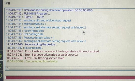

The second prototype stops after having downloaded the partition 0x02:
On the USB debug I have:

Please note:
  • We have seen many threads with "Reconnecting the device ..." issues but we could not find a satisfying solution for our custom board
  • After the reconnection fails, the board needs a complete power cycle OFF/ON, otherwise stm32cubeProgrammer can't detect the "USB1" anymore.
  • We have tried 2 Ubuntu 24.04 PCs, and one Mac (we don't use any VM): Same behaviour.
  • We use 2 different 12v power supplies to power the two prototypes.
  • We tried to flash the generic openstlinuxweston-stm32mp2 image. Same conclusion: EV1 flash+runs perfects. Prototypes stops at part 0x2/0x3.
  • We tried all the eMMC .tsv flashlayouts: optee, opteemin, fastboot, fastboot-opteemin. Again, same conclusion : EV1 flash+runs smoothly. Prototypes stops during flash process.
Any idea what could cause this "Unable to reconnect the target device" ?
Thank you
