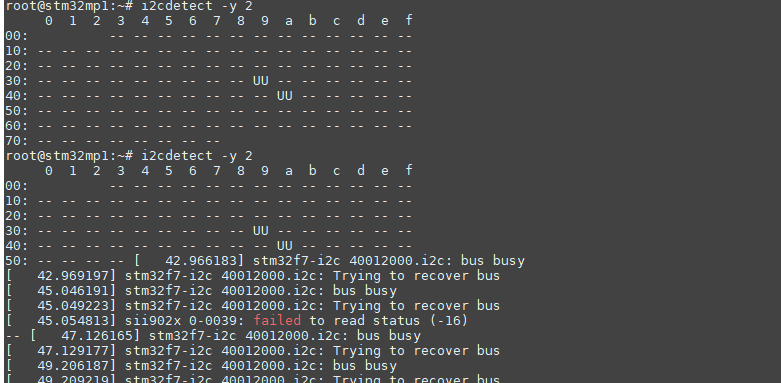

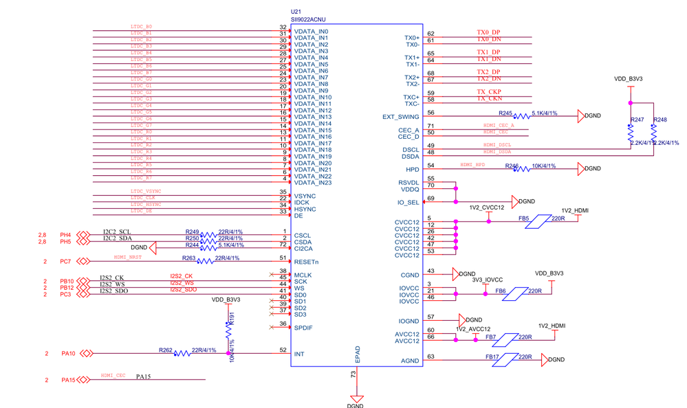

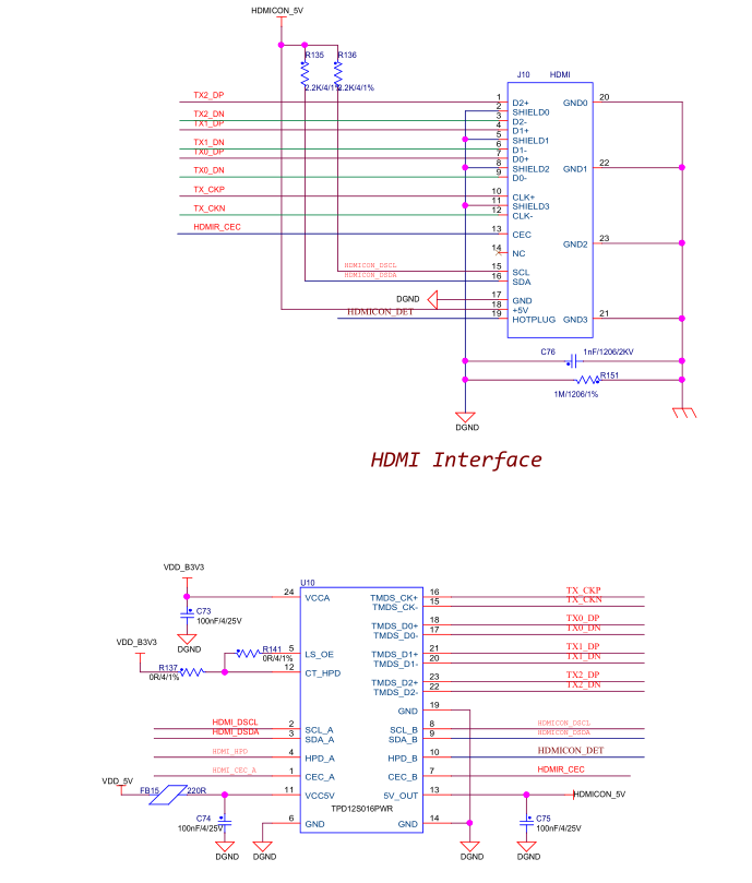

I designed a board based on the schematic of dk1, but I2C failed on HDMI output

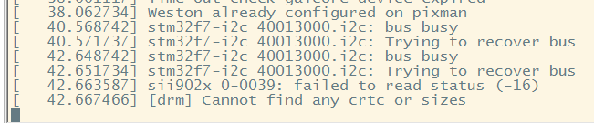

I am really describing the problem, I use HDMI direct connection monitor is good.But I get iic errors when I use HDMI to VGA.
I tested both the 4.19.9 kernel and the 4.19.94 kernel.
I also found some errors in the iic of dk1, see the following picture
