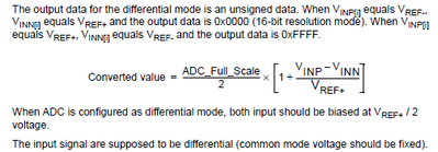

I am trying to measure voltages using the STM32MP157C's built-in ADC on channel 18 in differential mode, but keep getting wrong values. Linux kernel is 6.1.28.

Voltmeter readings:
  • 1.71 mV between INP18 (PA4) and GND
  • 1.39 mV between INN18 (PA5) and GND
  • 0.32 mV between INP18 and INN18
IIO values in /sys/bus/iio/devices/iio:device0:
  • in_voltage-voltage_offset = -32768
  • in_voltage-voltage_scale = 0.100708007
  • in_voltage18-voltage18_raw = 37273
So that's (37273 + -32768) * 0.100708007 = ~453.69 mV instead of the expected 0.32 mV as per Voltmeter.
In single-ended mode ("diff-channels" property removed), the IIO values make more sense:
  • in_voltage_offset = 0
  • in_voltage_scale = 0.050354003
  • in_voltage18_raw = 22
Here I get (22 + 0) * 0.050354003 = ~1.11 mV, which is close enough to the 1.71 mV measured by the voltmeter.
In differential mode, it looks like the computed values are off by a factor of 1000. I am, however, unsure if the "diff-channels" value is correct.
Am I doing this wrong? Is there a bug in the ADC driver in kernel 6.1?
Thanks and best regards,
Robert

Hi @rtie ,
as per Reference Manual and Datasheet, differential inputs are supposed to be bias at VREF+/2 +/-10%
This could explain the bad conversion results.
Regards.

Ah, I see. Our input signals are not centered around 1.65 V, so they are completely out of range. We'll change our hardware accordingly.
Thank you very much!
