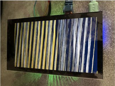

I encounter a problem with my LCD from Winstar model WF50DTYA3MNG10.
I have a custom board based on STM32MP157 with a display connected to Mipi 2 lanes.
On previous Openstlinux(kirkstone) without optee, the driver and display working well.
After switching to the latest Openstlinux I discover a problem with "ltdc fifo underrun"
root@telemach-somunknown:~# [ 96.350190] weston[1406]: memfd_create() called without MFD_EXEC or MFD_NOEXEC_SEAL set
[ 111.422211] [drm] ltdc fifo underrun: please verify display mode
[ 130.546427] [drm] ltdc fifo underrun: please verify display mode
[ 190.539247] [drm] ltdc fifo underrun: please verify display mode
[ 250.549608] [drm] ltdc fifo underrun: please verify display mode
[ 310.542950] [drm] ltdc fifo underrun: please verify display mode
[ 370.537518] [drm] ltdc fifo underrun: please verify display mode
[ 430.556994] [drm] ltdc fifo underrun: please verify display mode
Initialization seems to be without any errors

Display show
According to the log suggestion, I try to apply different modes
now I check
.mode_flags = MIPI_DSI_MODE_VIDEO | MIPI_DSI_MODE_VIDEO_BURST |
MIPI_DSI_MODE_LPM | MIPI_DSI_CLOCK_NON_CONTINUOUS,
but the screen always looks as in the attached image.
I think that's not display setting a problem but probably the kernel.
What can I do with such an issue?

2025-01-25 2:08 PM - edited 2025-01-26 2:33 PM
I've got an answer. It's simply the wrong clock configured in STMCubeMX(missing CLK_DSI_DSIPLL in st,clksrc). I checked again, set it correctly and now it's working as expected.
The topic can be closed.
BR
Michal
