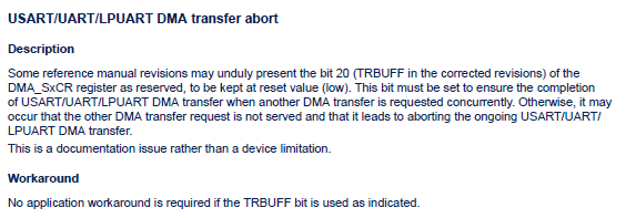

please double check the DMA TRBUFF bit is set when using DMA with UART.
In ES0438 Errata Sheet:
0693W00000QLPWXQA5.png0693W00000QLPYiQAP.pngOtherwise, to ensure M4 peripheral restart after some crash, you could Deinit and Reset the related peripherals before their init.

How do I check that bit 20 is enabled? The init code was autogenerated from STMCubeIDE.
Hi @cfilipescu​
seems this is a bug in HAL.
Could you please try adding:
/* USER CODE BEGIN 2 */
  (hdma_uart5_rx.Instance)->CR |= 0x00100000;
  (hdma_uart5_tx.Instance)->CR |= 0x00100000;
  /* USER CODE END 2 */
just after MX_DMA_Init();
Regards,
