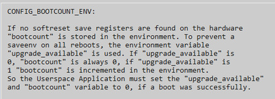

Im attempting to set up A/B partitioning on an STM32MP157d-dk1 board so that it can switch between partitions when updating. The board image is built using yocto, and I have used the meta-st-stm32mp layer, and am building a modified version of core-image-full-cmdline for the image.
I have set up fw_setenv and fw_printenv using the following fw_env.config file:

 This gives me access to the u-boot environment, and I can modify the bootlimit and upgrade_available variables without issue. However, bootcount is always overwritten on a reboot with its old value incremented by one, and it is incremented regardless of whether upgrade_available is set.
I have enabled bootcount in the uboot settings and have CONFIG_BOOTCOUNT_GENERIC=y set in the defconfig.
I am guessing one of two things is happening:
The bootcount variable is being altered by some other script within the image, in which case I will need some way to find what is modifying it
Or
The bootcount variable is stored elsewhere and is applied to the uboot environment on boot, in which case I need to find this location.

Setting CONFIG_BOOTCOUNT_ENV=y and CONFIG_BOOTCOUNT_LIMIT=y in the u-boot configuration before building fixes the problem. It also seems like upgrade_available is only used when CONFIG_BOOTCOUNT_ENV is set.
