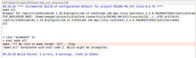

I set the SDKROOT correctly. And then `Setup OpenSTLinux` from the IDE. Then I `Import and OpenSTLinux` project. All of that I was successful. I used the command and the SDK to build the `Modify, rebuild and reload the Linux® kernel` and copied over the new OS to the DevBoard as directed in The WikI Webpage.

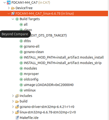

I can not build any of the build targets. The all give this error:

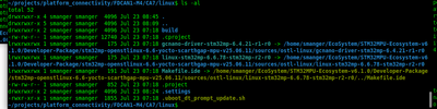

My Linux project structure is as follows:

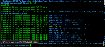

and the build directory contains a link to itself:
Here is my `ostl-linux` directory:
