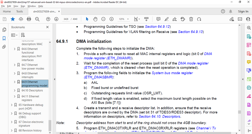

Actually, we are trying to reset the MAC registers by using DMA mode register (bit 0) in Ethernet section.
As per reference manual, we are set the bit(swr bit) to 1 in ETH_DMAMR_REG register. but it is not reset automatically.
In software we done

In this writing has completed but we are unable to read 0 from this register.
May be what is the issue ? can help me in this regards.

Hi @srikanth​ ,
in order to complete the reset, the GMAC need to have a clock present on its clk_tx and clk_rx clocks.
Please have a look to RM0436 rev.6 Figure 83 which give a very helpful view.
Which kind of PHY interface are you using ?
For RGMII and GMII, you need to have clock present on ETH_CLK125 (or internally from RCC).
for RMII, you need to have clock present on ETH_REF_CLK.
For MII, you need to have clock on both ETH_RX_CLK and ETH_RX_CLK
You also need to setup some SYSCFG bits before issuing the reset.

Now the reset issue has solved. we are able to write and read the ethernet registers.
We are using RGMII mode and internal RCC clock.
