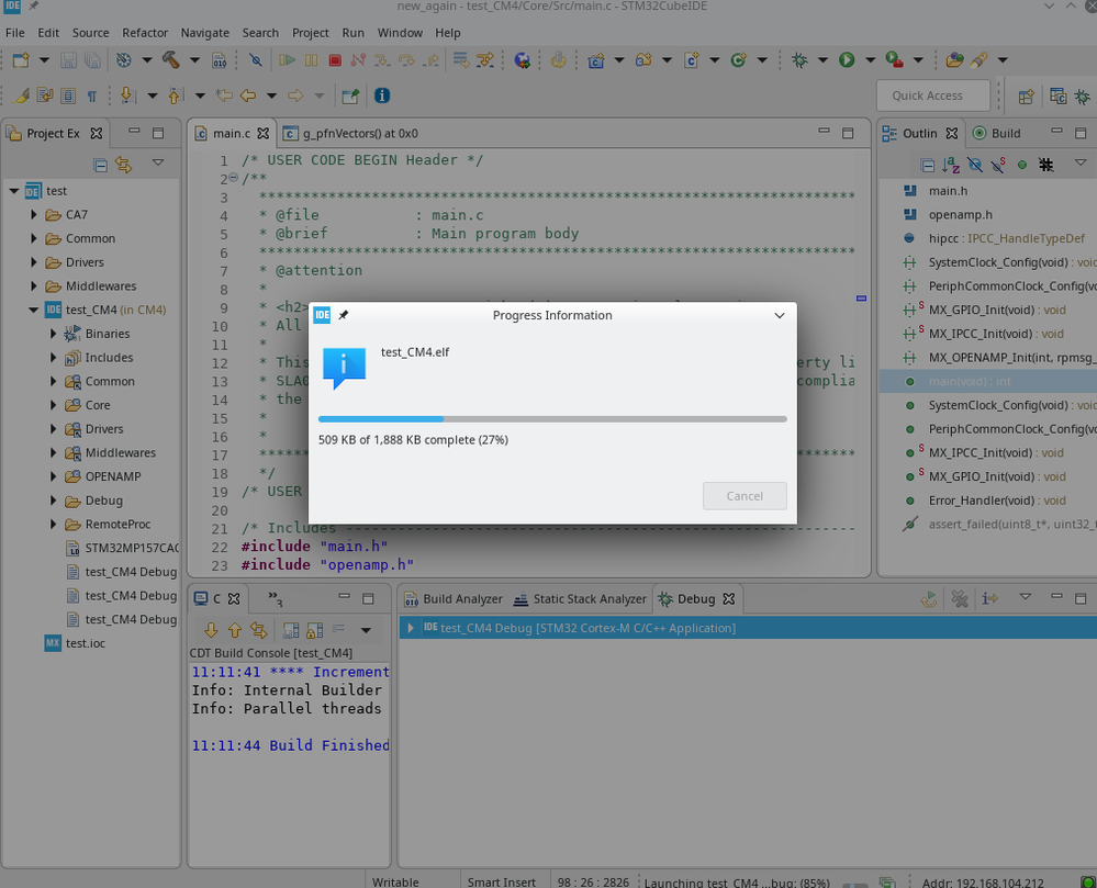

When looking in the /lib/firmware directory on the target, there is no uploaded elf file.
If I upload it by hand, load it into the co-processor, gdb seems to connect.
It is mainly because of the target upload.
On the thud distribution running on the target, the "Uploading to target process indication" flops up. This did not happen using my built using the dunfell distribution.
Is the CUBEIDE uploading via ssh scp?
Which yocto packages are necessary to cooperate with the CUBEIDE?

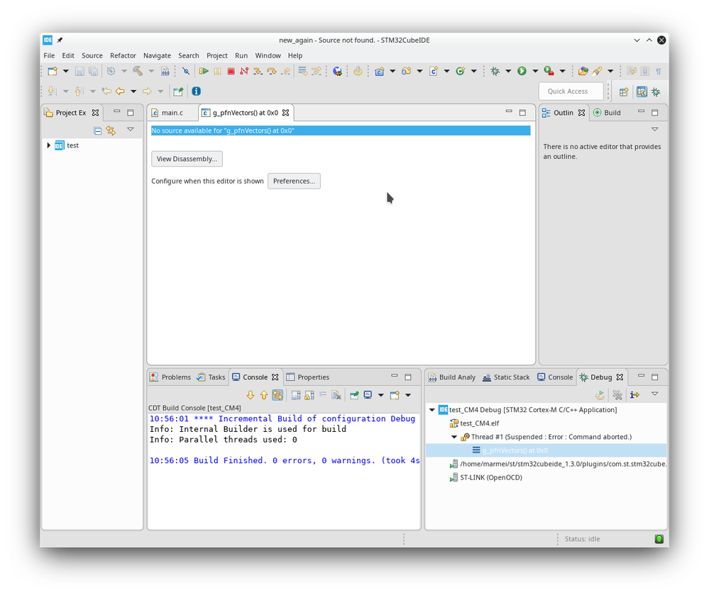

2020-07-09 2:00 AM
Messages on the CubeIDE is:
I am using ethernet via a different network, DHCP.
However for the thud build, I am using the same ethernet setup and it worked.
No source available for "g_pfnVectors() at 0x0"
It seems there were no shell commands executed on the target.
This is confusing me. What do you mean ?
This is the process indicator when using the the thud build on the target.
On dunfell I do not get so far. - Same network configuration, CUBEIDE was not restarted after target upload failure on the dunfell built.

OPENOCD Trace on the dunfell build:

2020-07-09 2:36 AM
Should I build my yocto with the previous openocd from thud?
Do you think this is an option?
2020-07-09 3:06 AM
Hi @meiss.M
I understand you use a dunfell image built with Distribution package ?
Can you make a try with the delivered Starter Package ?
Are you under windows or Ubuntu ?
If Ubuntu can you please share content of /etc/udev/rules.d/49-stlinkv2-1.rules ?
