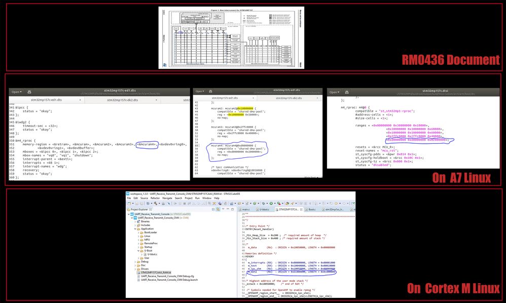

i can run linux on stm32f429 mcu without any problem, but it failed on Cortex-M MCU in stm32mp157 board.
After many hours i realize:
error happens in below function
void __meminit __free_pages_bootmem...
Anyone else had a similar problem? how you resolved it?
Shall i change any register address in kernel? (i think every thing is the same in cortex-M4 and stm32f429).
Best regards

After too many ties i can access the attachment picture, Could you understand my recent status using sending image?
Could you help me?
Kind regards

I am running "production" mode and accessing DDR3 is available for me.
Im not worried a bout performance or running speed.
according to RM0436 datasheet i can access to DDR content without any problem.
i have done the following settings on Cortex-A and Cortex-M. please check attached file...
if it is hardly readable tell me to send each of them separately.
i mentioned it:backhand_index_pointing_down: :
"error happens in below function
void __meminit __free_pages_bootmem..."
i dont know any thing a bout mentioned function. Does that function error occur in a particular situation?
