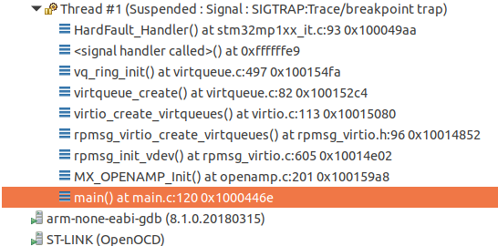

But, to answer your question, I get a hard fault in Engineering mode. 0693W000007CB6vQAG.png...this would also be nice to solve, as it renders debugging in engineering mode impossible.

You should not call MX_OPENAMP_Init() in Engineering mode, because there is no other side - A7, there is only M4 running. You should place MX_OPENAMP_Init inside if(!IS_ENGINEERING_MODE).

@NGajic​ , that makes sense. Though, CubeMX generates the code that calls it outside of the engineering mode check. I'll guess I can hack a wrapper around the auto-generated code.
