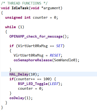

I'm not using debug mode. I'm running the firmware with echo start > /sys/class/remoteproc/remoteproc0/state. Here is my flow:
- Build the binary (HAL_NVIC_EnableIRQ(TIM2_IRQn) is added after HAL_Init)
- Transfer binary using SCP client (WinSCP)
- Copy binary to /lib/firmware
- echo OpenAMP_FreeRTOS_echo.elf > /sys/class/remoteproc/remoteproc0/firmware
- echo start > /sys/class/remoteproc/remoteproc0/state
- echo stop > /sys/class/remoteproc/remoteproc0/state

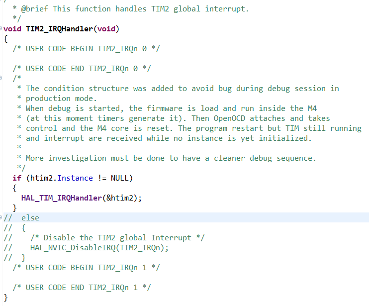

Do the 5. and 6. several times and the diode stop toggling. Code is OpenAMP_FreeRTOS_echo with added HAL_Delay(10) before if where diode is toggled (picture). Another question is how your TIM2_IRQHandler looks? Mine is on picture below.

Hi @Community member​ ,
I think that I find out what is happening here... We are doing HAL_Init, and there HAL_InitTick is called, first HAL_NVIC_EnableIRQ is done, and several lines after htim2.Instance is set to TIM2. There's a problem, because interrupts are enabled, HAL_TIM2_IRQHandler is called and there:
if (htim2.Instance != NULL)
HAL_TIM_IRQHandler(&htim2);
else
/* Disable the TIM2 global Interrupt */
HAL_NVIC_DisableIRQ(TIM2_IRQn);
So we will enter into else and TIM2_IRQn will be disabled because htim2 instance is not set. Because that if you add HAL_NVIC_EnableIRQ is working the job when placed after HAL_Init. So what is maybe better solution?

‎2021-02-01 1:46 AM
Hi @NGajic​ , @JCant.1​ ,
This is final explanation for the issue :
The issue is caused by one interrupt from the previous execution
that remains pending in the NVIC.
The new execution erroneously enable the TIM2 interrupts 'before'
setting in the handler:
/* Initialize TIM2 */
htim2.Instance = TIM2;
The pending interrupt immediately triggers the execution of the
IRQ handler TIM2_IRQHandler(), which finds 'htim2.Instance' not
initialized yet and, in response to this spurious interrupt,
disables the just enabled TIM2 interrupts.
This issue is more evident by using CubeIDE; to restart a new run
of the example, CubeIDE first halts the target core, then quits
from the debugger and restarts the firmware. When the core is
halted, TIM2 is still running, thus feeds in NVIC the interrupt
that will deterministically hang the next execution.
Patch attached.
