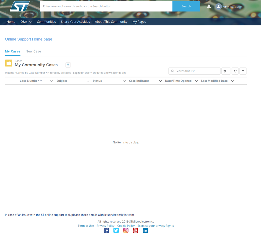

AMurr.2282
Hi @Emmanuel COMBETTE DE RYMON​
I am trying to find my OLS case 94533 but it's not showing up in my list. This is all I see when I go to my.st.com/ols:
Hi
