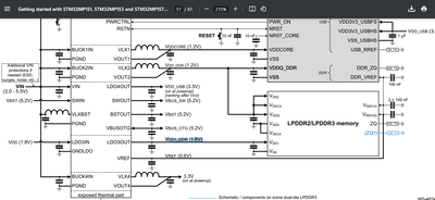

Custom STM32MP151A board with 512MB DDR2.
I am trying to write via UART communication with STM32CubeProgrammer, but BL32 processing does not start.
What should I do to investigate the cause?

Also, if your board still fails at the end of SP_min then I may have an idea why.
You are using LPDDR2 and in that case LDO3 should be in bypass mode (if used as intended by ST) and not in sink-source mode (this is for standard DDR). LPDDR not use VTT voltage at all.
