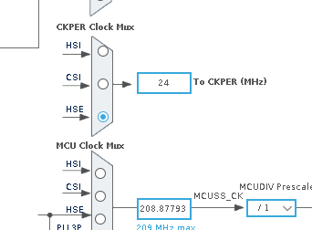

@Erwan SZYMANSKI
Hi! It seems that I have the same clock configuration. So this means it must be a bug?
Here is my device tree for Op-tee. Do you see something suspect? ;)
&rcc{ pinctrl-names = "default"; pinctrl-0 = <&rcc_pins_mx>; status = "okay"; /* USER CODE BEGIN rcc */ /* USER CODE END rcc */ st,clksrc=< CLK_CKPER_DISABLED <------------ CLK_ETH_PLL4P CLK_SDMMC12_PLL4P CLK_STGEN_HSE CLK_SPI2S23_PLL3Q CLK_I2C46_HSI CLK_USBO_USBPHY CLK_CEC_LSE CLK_I2C12_HSI CLK_UART24_HSI
After fix:
By the way! CubeMX will clean the whole U-boot-mx.dts file in the device tree when I'm generating new code. It's two bugs counted now! Try it your self. Create and STM32MP151AAC3 project and write something within BEGIN and END commands of the U-boot-mx.dts file inside the DeviceTree folder. Then generate. See if it's disappear.

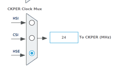

For the CubeMX configuration, you say that the PER clock is not inside, I am a bit surprised. Can you please double check, I can see this on my side (taken with the STM32MP157F-DK2 example project) :

@Erwan SZYMANSKI
Oh, it's called CKPER clock. Intill check. I very sure it exists for MP151.
It might be the issue, i guess.
I will reply later.

@Erwan SZYMANSKI
After fix:
