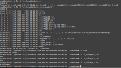

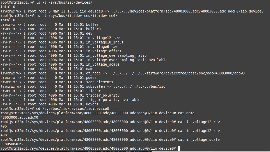

I having some difficulties figuring out details about the ADC usage under Linux, in particular on the MP135F-DK.
I located the io driver sources, and the drive itself seems to work:
Checking the board user manual, the GPIO pins PC2 and PC3 are routed onto CN8, and seem available for application usage as ADC inputs.
Can I access this two channels via the existing  /sys/bus/iio/devices  interface ?
Or would I have to modify the sources ?

Do the definitions marked in red mean only this specific channels are available ?
1 reply
Visitor II
November 9, 2024
