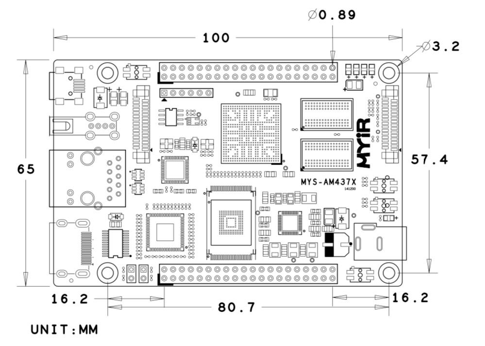

Hi Olivier, thanks for the quick reply :)
The STEP file looks a bit like overkill, to be honest - but I'll try and find a viewer for the format on my Mac, and see if I can get the info I need. What I really wanted (I mention this in case it's there and I missed it) was something like:

Olivier GALLIEN
Hi @Spaced Cowboy​
No, we do not provide similar details measure file.
Don't you get information using Altium PCB file in ODB+ folder ?
Hope it help,
Olivier
