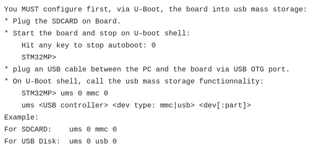

I use stm32mp157a-dk1 board and sdcard boot.
Host PC is win10, virtualbox and ubuntu 20.04.1
I try this example but have some problem.
I don`t have folder "/media/$USER/bootfs/" and media/$USER/rootfs/lib/modules/
My board complete this step.
But error occurs this command .
/media/sh/bootfs/ is not directory. (*'sh' is my user name)
What is problem? ^^;;

Hi @Community member ?
When proceed to :
STM32MP > ums 0 mmc 0

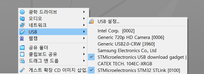

A new USB "STMicroelectronics USB Download gadget" should be visible in your Virtual Box. Please check it's not connected windows side.
You should get something like :

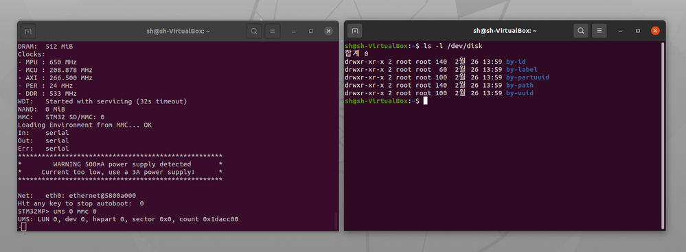

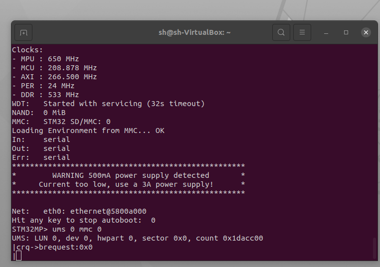

2021-02-25 7:52 PM
Hi, @Community member
I connected USB in Virtual Box but keyboard is stopped in kernel folder(install_artifact) console.
And at the moments, board is reboot and kernel folder console is available.
So I can`t command ls -l /dev/disk/by-partlabel/ cuz can`t use keyboard.
What is problem? T.T

Hi @Community member ,
I'm afraid this is purely related to your VirtualBox environment for which I can not help much.
Double check and try to get help on some dedicated community.
