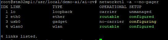

Could you please share results of :
$> networkctl -a --no-pager

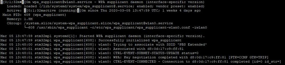

and
  $> systemctl status wpa_supplicant@wlan0.service

SChau.2062
Following is the result of $> networkctl -a --no-pager:
The output of  $> systemctl status wpa_supplicant@wlan0.service is as follow:
FYI: I am going to connect STM32MP1 to my machine (wifi enabled) using Ethernet so that STM32MP1 will get internet connectivity through Ethernet.
