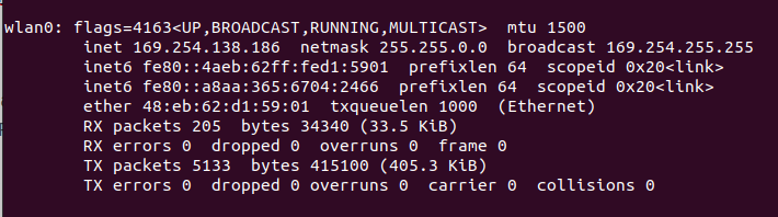

After that, i am able to see the AP when I look in a smartphone, but after logging with the password configured, I see the message "IP configuration failure " on my smartphone.
One thing I see suspicious is the inet when i run the command "ifconfig"

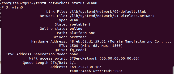

Another thing i see weird is when i run the "networkctl status wlan0" command, specifically the Network File variable

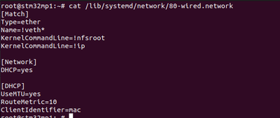

  4. This is the content of my /lib/systemd/network/51-wireless.networkobedPH_0-1693935610318.png
  5. This is the content of my /lib/systemd/network/80-wired.network obedPH_1-1693935688706.png
    Thank you very much, regards
