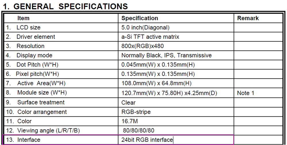

When we look at the general specifications of the display panel, we see the display interface supports 24-bit RGB:
Under Pinout & Configuration Tab, we select Multimedia category and then LTDC peripheral. Under LTDC Mode and Configuration, we select the display Type: RGB888 (24 bits).

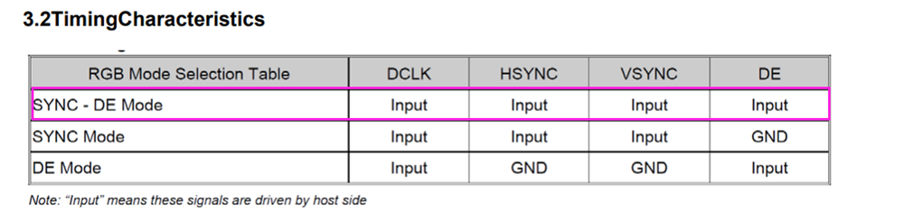

The display panel supports three modes: SYNC mode, SYNC-DE mode, and DE mode. We’re more interested in SYNC-DE mode as it uses the three signals: Pixel clock (DCLK), HSYNC, VSYNC, and Data Enable (DE).
The display panel has already VDPOL and HDPOL tied to High. This means the VSYNC and HSYNC are active low. Besides, the figure below shows the DE signal is active high.
Based on the signal polarity given by the datasheet of the display panel, we provision the configuration under Signal Polarity.

SPoor.1
Hi @Laura C.​ , thanks a lot for your post. Just a small note:
"Only the DE control signal must be inverted versus the DE polarity indicated in the display
datasheet. The other control signals must be configured exactly like the display datasheet."
