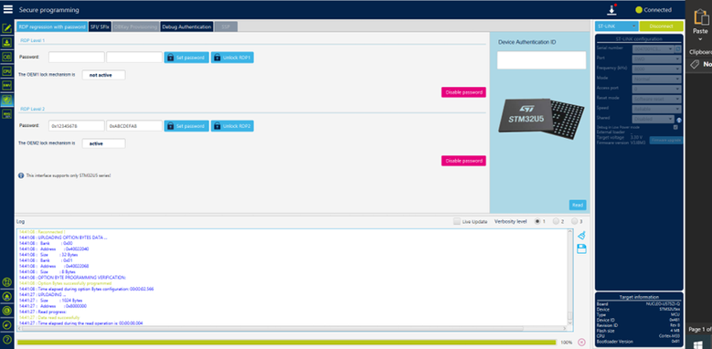

1. How to define an OEM password
To define an OEM2 password, you must do the following:

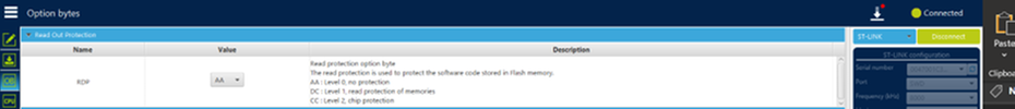

1.Check if your sample is on RDP level 0 (no protection).

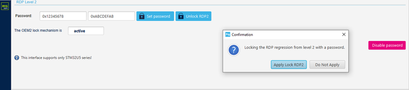

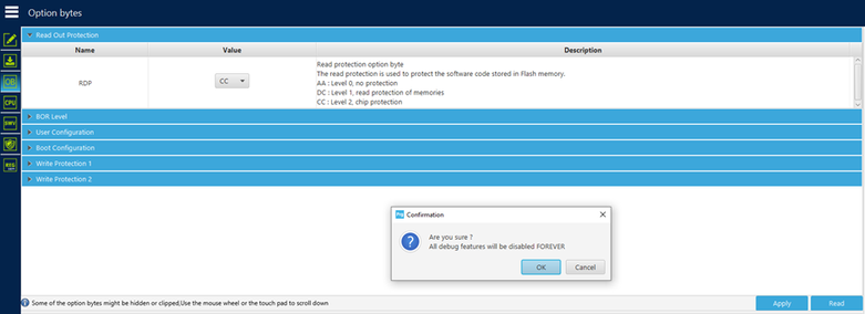

2. How to take the RDP from level 0 to level 2
After clicking on "ok" you will lose your connection with STLINK. This is normal behavior.

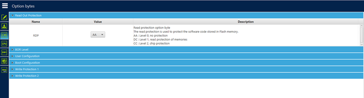

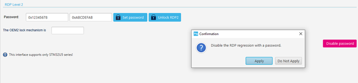

3. How to regress from RDP level 2 to level 0
Go back to the "secure programming" menu:
You have correctly downgraded the RDP from level 2 to level 0.

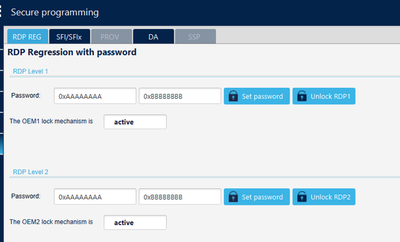

Does this also work with keyed RDP level 1?
- Mark as Read
Hello @RCana.2,
The process is the same for RDP Level 1.
Just be sure your password has been defined in OEM1KEY.
Regards
DianeP

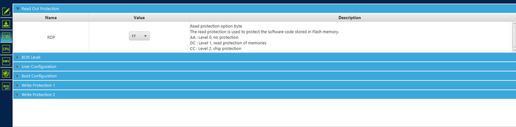

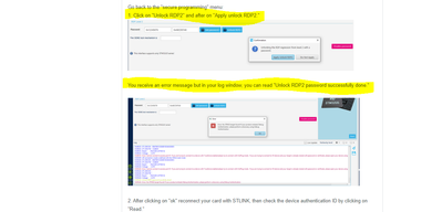

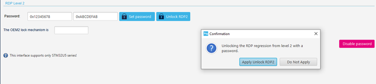

In this how-to I read:
"After clicking on "ok" you will lose your connection with STLINK. This is normal behavior."
Then in step 3 I should go back to the "secure programming" menu and Click on "Unlock RDP2" and after on "Apply unlock RDP2."
But I was disconnected, should I connect again before this step? With what configuration: JTAG or SWD? Which mode? Which Reset mode?
I followed the procedure, but I bricked another chip: at the moment if I try to conect to the chip I get the following error:
Error: No STM32 target found! If your product embeds Debug Authentication, please perform a discovery using Debug Authentication
How can I regress from RDP2 to RDP0 if I can't connect to the chip?

Hello @Manuel Ferrero @RCana.2
This is a tool bug where step 1 has to be done twice.
Workaround :
Can you retest on your two boards by doing step 1 <<Go back to the "secure programming" menu and Click on "Unlock RDP2" and after on "Apply unlock RDP2">> 2 times before moving on to step 2?
if you have correctly defined your password, no worries, go back directly from this step, you can regress to level 0.
Internal ticket has been created to solve this bug.
Internal ticket number: 157559 (This is an internal tracking number and is not accessible or usable by customers).
Regards
Diane

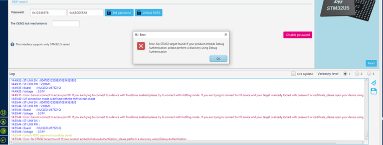

If I try to follow your procedure and press "Unlock RDP2" and then "Apply unlock RDP2", I get the same error.

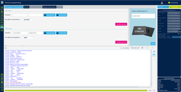

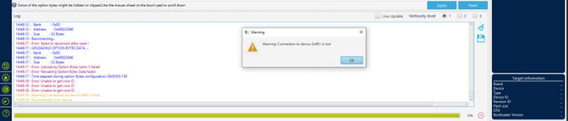

@Diane POMABIA , @Jocelyn RICARD hello, I'm working on a STM32U595 and I encountered the same issue (not being able to do the regression from RDP2 to RDP1 even with my OEMKEY1 and 2 set etc.
First of all I configured OEMKEY1 and 2 :
Then I followed the full process using Reference Manual + a nice tutorial by ST
However, it doesn't work, I have two weird behavior :
If I use STM32CubeProgrammer I can read the Auth device ID :
But I can't unlock RDP2 (By the way I tried twice as you answered above):
I tried in command line and what a surprise to see " Unlock RDP2 password failed!"
At some point, I was like "oh it's me, I typed the wrong password", so I tried on an other STM32U595, we were two doing it, so double check. Same issue happened.
Could you help me regarding this issue. By the way I was using STM32CubeProgrammer 2.14 (last version), I was Under Reset for unlock sequence, and hotplug mode to get auth device. I also tried to save my chip by putting 3.3V on BOOT0 pin, but looks like I can't connect to debugger or do anything more.
Kind regards

Thanks to @Diane POMABIA I solved my issue. The problem was just my STLink version not up-to-date, you must have at least V2J38 STLink FW Version to process regression! Now with V2J42S7 everything is fine!
- Mark as Read
@eSenKaa as discussed in inbox, your problem was related to your version of STLINK.
To perform a regression, your STLINK FW version Must be at least V2J38 for ST-Link/V2 and V3J8M3 for ST-Link/V3.
We recommend that you always use the latest version of STLINK.
Pleased to be able to help you.
Regards
Diane
OPTION BYTES BANK: 0
Read Out Protection:
RDP : 0xAA (Level 0, no protection)

UPLOADING OPTION BYTES DATA ...
Bank : 0x00
Address : 0x40022040
北北北北北北北北北北北北北北北北北北北北北北北北北 0% 圹圹圹圹圹圹圹圹圹圹圹圹圹圹圹圹圹圹圹圹圹圹圹圹圹 100%北北北北北北北北北北北北北北北北北北北北北北北北北 50% 圹圹圹圹圹圹圹圹圹圹圹圹圹圹圹圹圹圹圹圹圹圹圹圹圹 100%
Bank : 0x01
Address : 0x40022068
PROGRAMMING OPTION BYTES AREA ...
北北北北北北北北北北北北北北北北北北北北北北北北北 50% 北北北北北北北北北北北北北北北北北北北北北北北北北 0%
Bank : 0x00
Reconnecting...
Error: failed to reconnect after reset !
Bank : 0x00
Error: Uploading Option Bytes bank: 0 failed
Error: Reloading Option Bytes Data failed
Time elapsed during option Bytes configuration: 00:00:07.030

Unlock RDP2 password succefully done!
Error: Cannot connect to access port 0!
If you are trying to connect to a device with TrustZone enabled please try to connect with HotPlug mode.
If you are trying to connect to H5 device and your target is already locked with password or certificate, please open your device using Debug Authentication.
C:\Program Files\STMicroelectronics\STM32Cube\STM32CubeProgrammer\bin>STM32_Programmer_CLI.exe -c port=SWD mode=UR -unlockRDP1 0x12345678 0xABCDEFAB
STM32CubeProgrammer v2.13.0
ST-LINK SN : 53FF71068389505253152567
ST-LINK FW : V2J40S7
Board : --
Voltage : 3.39V
If you are trying to connet to a device with TrustZone enabled please try to connect with HotPlug mode
C:\Program Files\STMicroelectronics\STM32Cube\STM32CubeProgrammer\bin>STM32_Programmer_CLI.exe -c port=SWD mode=UR -ob RDP=0xAA
Board : --
Voltage : 3.39V
C:\Program Files\STMicroelectronics\STM32Cube\STM32CubeProgrammer\bin>STM32_Programmer_CLI.exe -c port=SWD mode=UR -unlockRDP1 0xFFFFFFFF 0xFFFFFFFF
Board : --
Voltage : 3.38V
C:\Program Files\STMicroelectronics\STM32Cube\STM32CubeProgrammer\bin>STM32_Programmer_CLI.exe -c port=SWD mode=UR -ob displ
Board : --
Voltage : 3.39V
