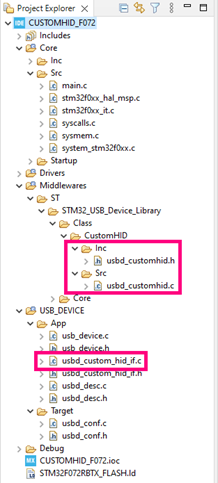

We resume from the point we left off, just to give a brief recap, in part 1 we made all the way up to the code generation with STM32CubeIDE:
Among the several files created automatically, the highlighted ones are modified during this tutorial, so you might want to open them preemptively:
 The first step in the code is to increase the IN and OUT Endpoint size. Just to do a small recap, the Endpoint is the source or destination data buffer that must be implemented on the device side, each amount of data that is received from or sent to the host will be placed into an endpoint. In the usbd_customhid.h file, modify the CUSTOM_HID_EPIN_SIZE and CUSTOM_HID_EPOUT_SIZE defines to 0x40 (64 bytes):

NOTE: All the modifications on files inside the middlewares folder may be overwritten in case of code generation from STM32CubeMX. So, create a copy of the files when the modifications were finished.
Open the usbd_customhid.c file and modify the following functions:

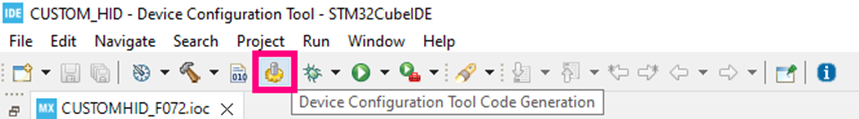

Done! By building the application the dream of all programmers should be achieved, 0 errors and 0 warnings. Now let us see if it also works.

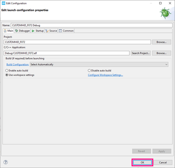

2. Validation
Start a debug session with the created project with STM32CubeIDE by clicking in the Debug button:
A window may appear to ask for some settings about the Debugger, for this example the standard settings work well. So, just click on Ok:
Run the execution clicking Resume button or pressing F8:

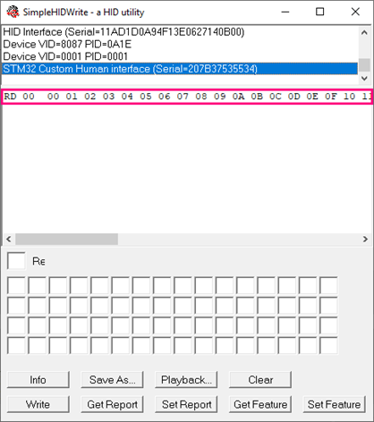

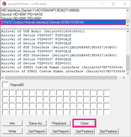

Open the SimpleHIDWrite software, select the STM32 Custom Human interface in the list, then click on Clear button to clear the terminal:
Press the User Button on the Discovery Board and check that the buffer sent to host on terminal. It is the buffer with the sequence from 0 to 63U (0x3F):

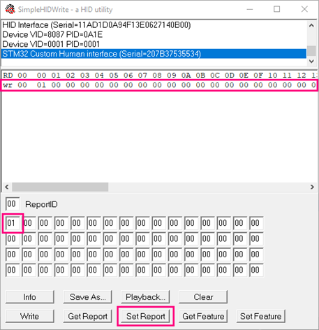

Fill the first field with the value 1, click on Set Report button and check that the Red LED turned ON (change the first value to 2 and send the report again to turn OFF the LED):533.png

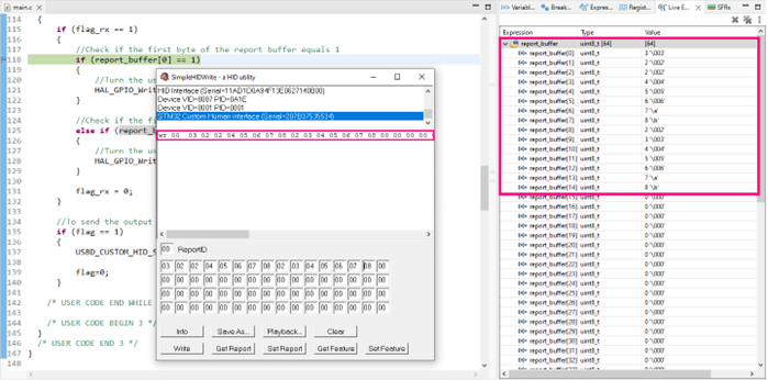

Finally, insert a breakpoint on some line between the if statement of main.c that checks the flag_rx, fill the fields of the SimpleHIDWrite with random data, set a report and check the value of the report_buffer on STM32CubeIDE:
