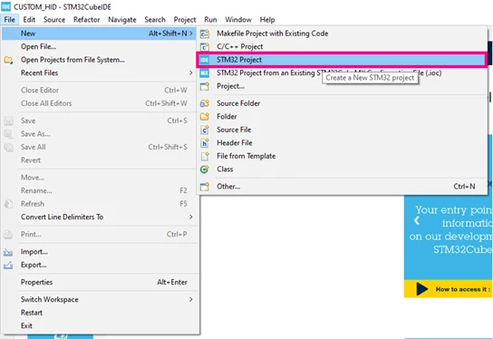

First, let us start creating a project for STM32F072RBT6 on STM32CubeIDE (the steps regarding the microcontroller’s settings can be done on STM32CubeMX instead). After opening the software, click on File -> New -> STM32 Project:

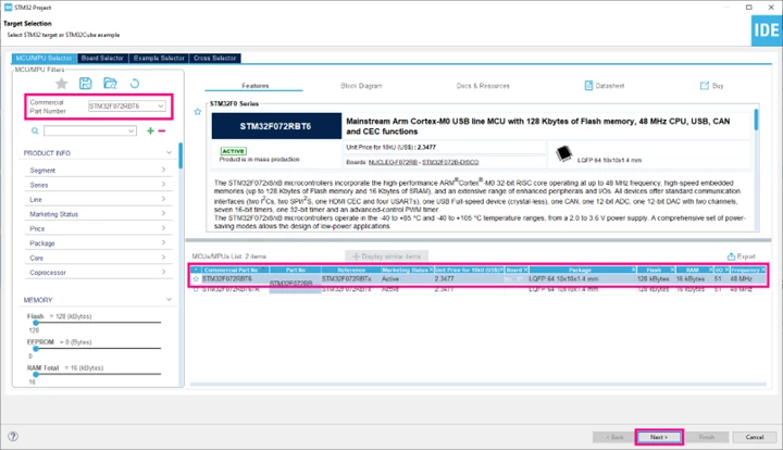

In the opened menu, search for STM32F072RBT6 microcontroller, then select it in the list, then click Next:

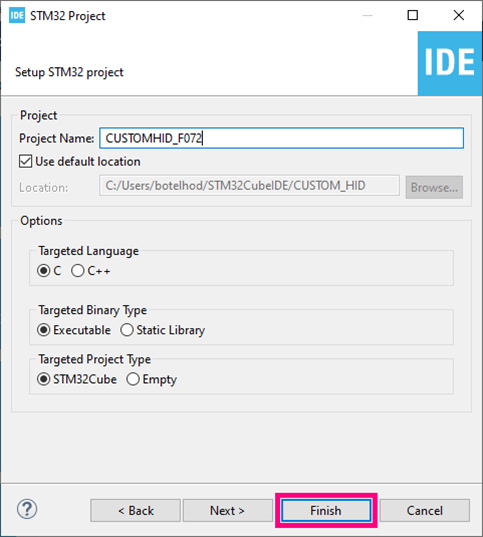

Give a name to your project, let the standard settings, then click on Finish:

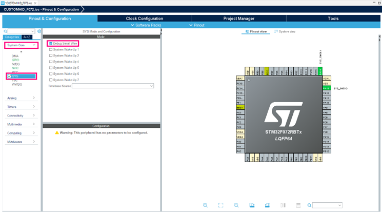

          After the microcontroller shows up, set the SWD (Serial Wire Debug) pins. This step is optional but is a good practice to know which pins will be used to program and debug the microcontroller to avoid wrong settings. To do this, go to System Core -> SYS then enable the Debug Serial Wire:

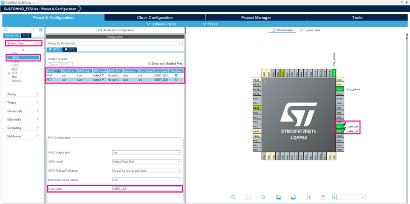

          There are 4 User LEDs on the current board. We use only two of them, User LD3 (red LED) and User LD6 (blue LED) that are connected to the PC6 and PC7 microcontroller’s pins, according to the Discovery kit for STM32F0 Series microcontrollers with STM32F072RB - User manual. So, set these pins as GPIO_Output and give their respective labels:

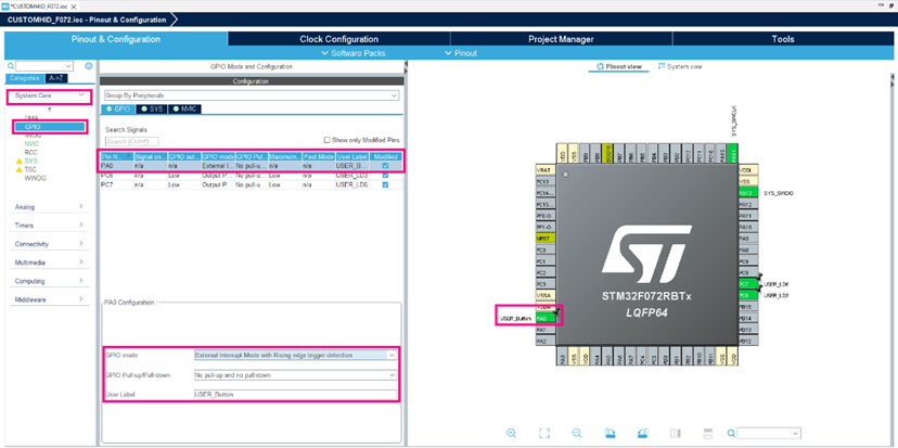

          There is also a User Button on the board. It is connected to PA0 pin. So, set this pin as GPIO_EXTI0, then give the settings below (there is a pull-up and low-pass filter circuit connected to the button on the board):

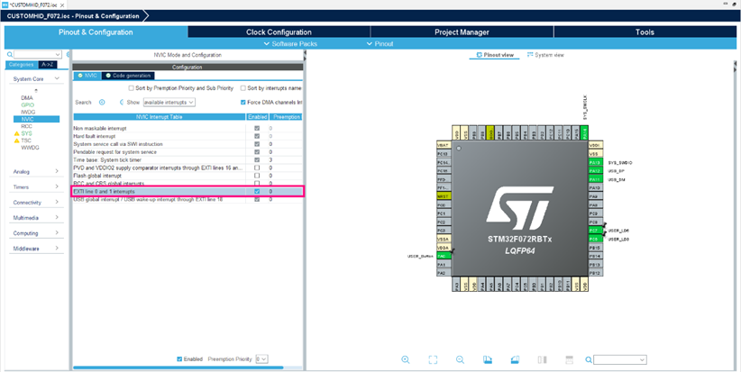

          Enable the external interruption checking the EXTI line 0 and 1 interrupts on System Core -> NVIC:

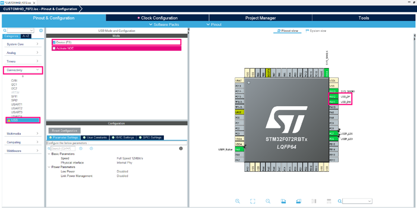

          Now, let us start to set the USB configuration. Go to Connectivity -> USB then enable the Device (FS) resource. Keeping the default settings work just fine (Note that two pins will automatically be enabled when the USB is activated).

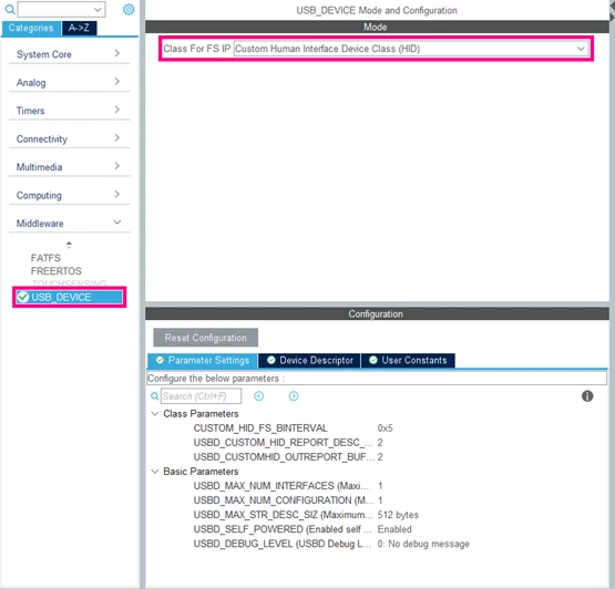

          Open the Middleware -> USB_DEVICE and select the Custom Human Interface Device Class (HID) on Class for FS IP:

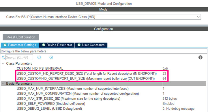

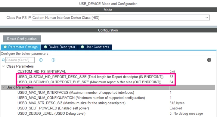

          In the USB DEVICE settings (the same menu of the previous step) change the USBD_CUSTOM_HID_REPORT_DESC_SIZE to 33 (it is necessary to increase the data of the USB Descriptor to add some information that will be used to describe the custom class that will be implemented). We must edit the USBD_CUSTOMHID_OUTREPORT_BUF_SIZE to 64, this is done to increase the data package length. All other settings can be kept as default:

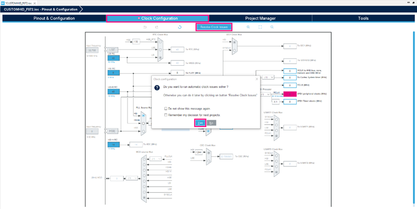

          Now, we adjust clock configuration. As mentioned earlier, the Clock Configuration tab should have an icon showing that we have an error on it. Moving to this tab a window appears asking whether you want to solve the clock issues or not, click Yes:
          If the window did not appear, click on Resolve Clock Issues, and let the tool calculate the best values for the settings done until here. Note that this particular STM32 does not require an external clock source (HSE) for the USB application, thanks to the Crystal-less USB 2.0 feature of the STM32.
