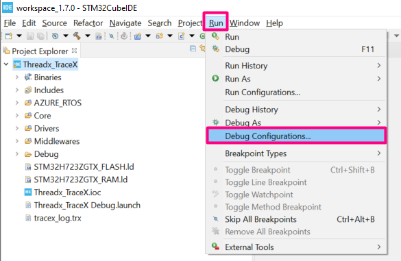

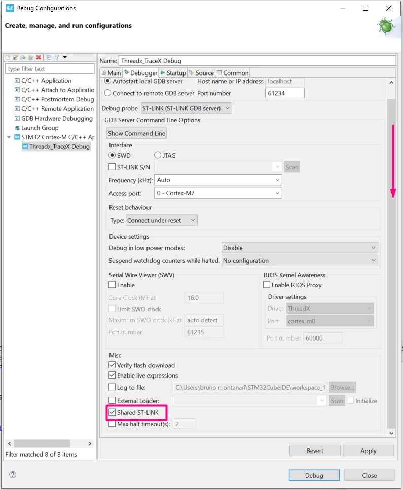

  1. Open your STM32CubeIDE project with TraceX and ThreadX enabled and go to the Debug configurations:

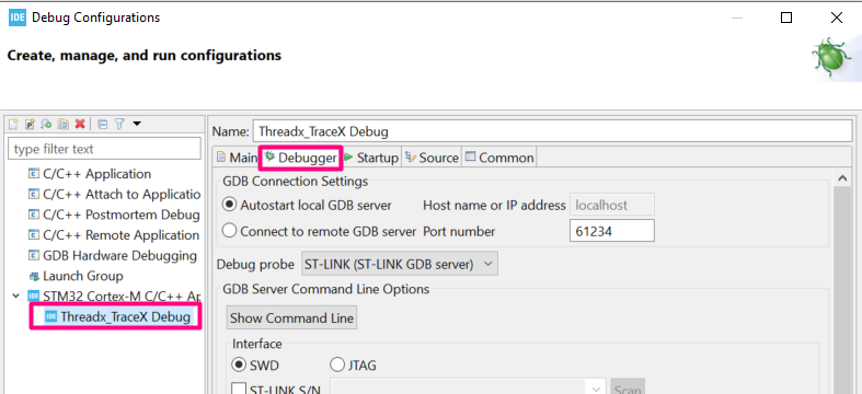

From this point, select the application and click on the “Debugger” Tab:
Scroll down and check the Shared STLINK option:
This option allows you to use ST-LINK with both the STM32CubeIDE for debugging and at the same time with the STM32CubeProgrammer, which can read the trace buffer content.

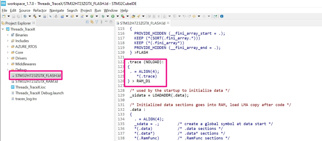

  1. Now we need to place the buffer used for the trace in a fixed memory region, so the address is known to us and can be easily found and mapped for the STM32CubeProgrammer later on
In order to do this, we need to edit the linker script to add it. If you are using the same settings from this article, this step is already implemented.

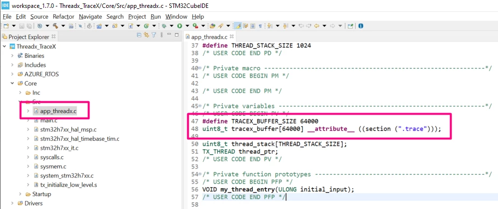

Make sure that the buffer used for the trace is placed inside this newly created section, this can be done by using the __attribute__

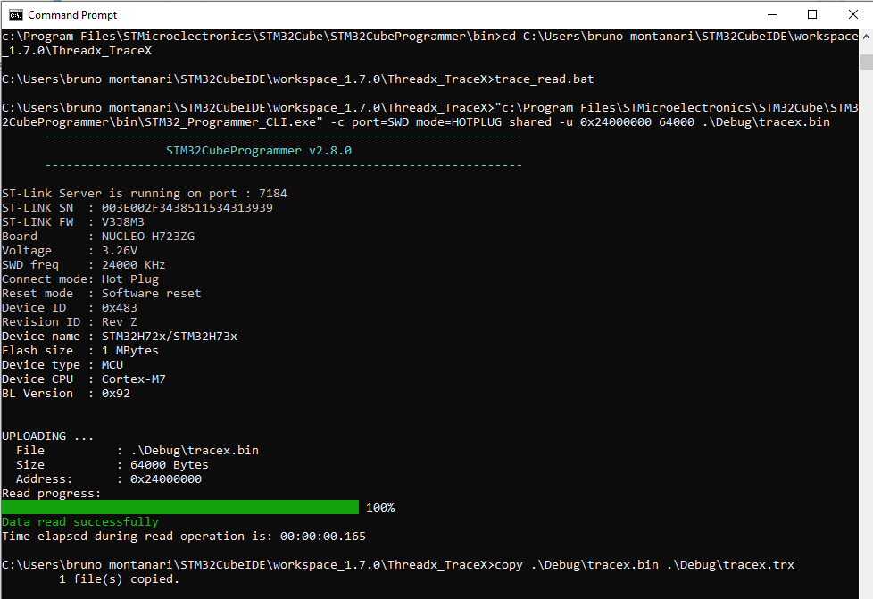

  1. Create a *.bat file, in this example, it will be called “trace_read.bat”. Make sure to place it into the same place as project *.IOC file / root folder for the STM32CubeIDE project
The content of the trace_read.bat assumes that the STM32CubeProgrammer installation path was the default c:\Program Files\STMicroelectronics\STM32Cube\STM32CubeProgrammer\, if this is not your case, please make sure to properly edit it.
The content of the trace_read.bat is:
"c:\Program Files\STMicroelectronics\STM32Cube\STM32CubeProgrammer\bin\STM32_Programmer_CLI.exe" -c port=SWD mode=HOTPLUG shared -u 0x24000000 64000 .\Debug\tracex.bin
copy .\Debug\tracex.bin .\Debug\tracex.trx
Explaining the commands used:
The first portion of the command is just to make the current directory to the installation folder of the STM32CubeProgrammer
The second portion command calls the STM32CubeProgrammer CLI and uses the SWD interface to make a connection without resetting the MCU, thus the setting called HOTPLUG and, since the ST-LINK is shared with the STM32CubeIDE, the information is also added:
This will read 64000 bytes started from address 0x24000000  and store that to file .\Debug\tracex.bin

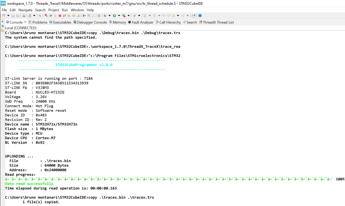

  1. Enter in debug mode and run the application, after a while the trace buffer will be filled as the application progress, so you can run the trace_read.bat, while still in debug, to create your tracex.trx (TraceX file)
    1. You can call the trace_read.bat by double clicking in it
    2. You can call it by first issuing the cmd.exe

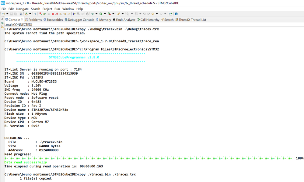

    1. You can open a local console from within the STM32CubeIDE

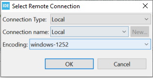

In the lower left corner, locate and click to create a new Command Shell Console:
Select the connection to be local:
On the terminal, change the directory to be in the project’s folder and then call the trace_read.bat from there:

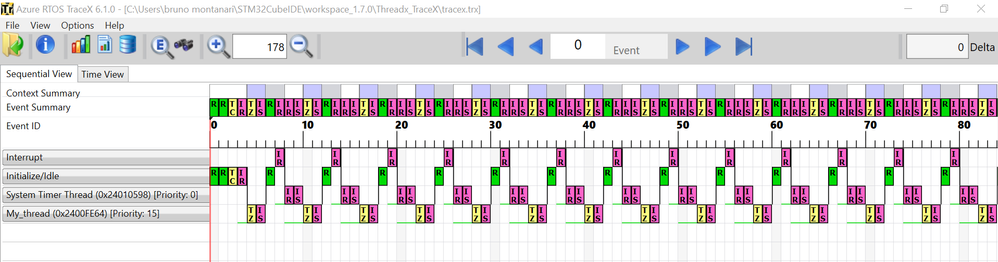

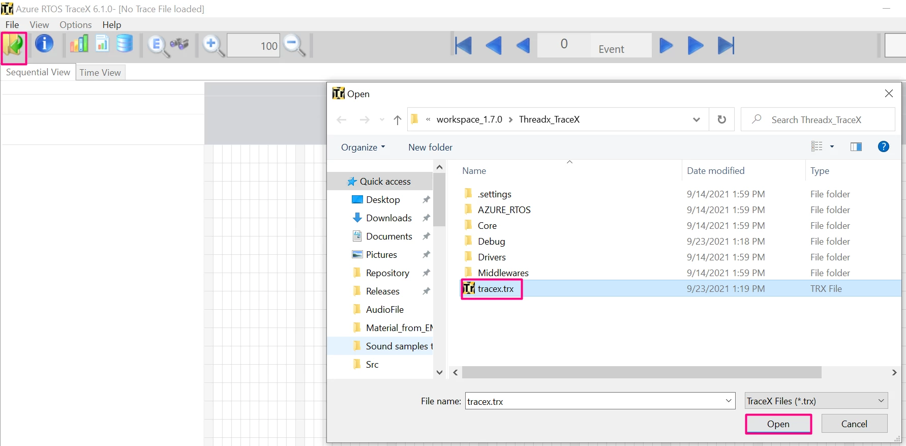

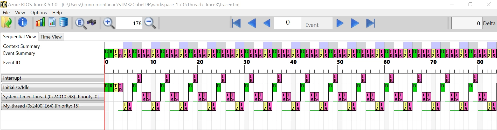

  1. Open the TraceX and load the tracex.trx and enjoy :)
