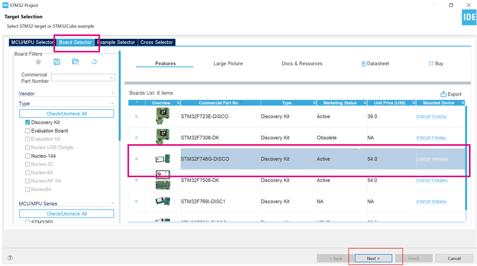

STM32 Discovery kits as well as evaluation boards include an SD card socket. While this example uses the STM32F746G-DISCO board, any other STM32 board with an SD card socket can be used. Ensure appropriate changes are made in the software configuration to accommodate a different target board.

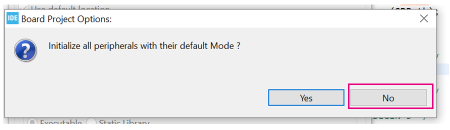

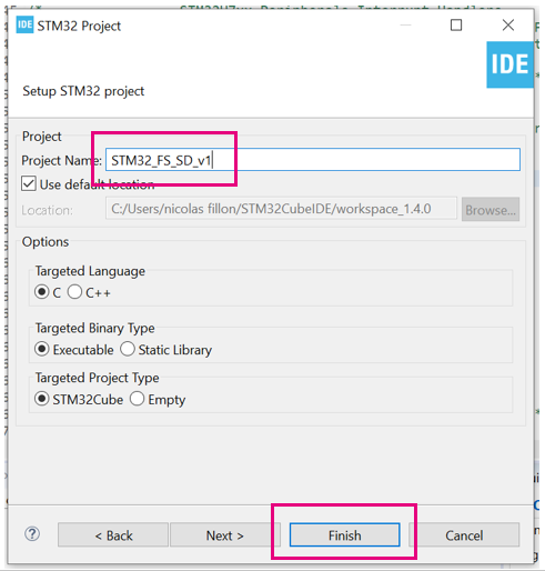

Firstly, we need to create a STM32CubeIDE project where we configure the application to interface with the SD card.

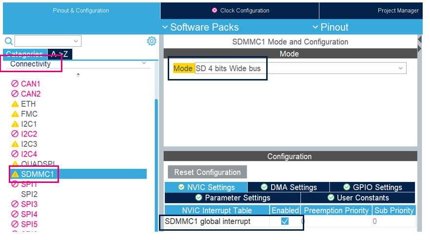

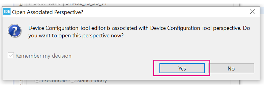

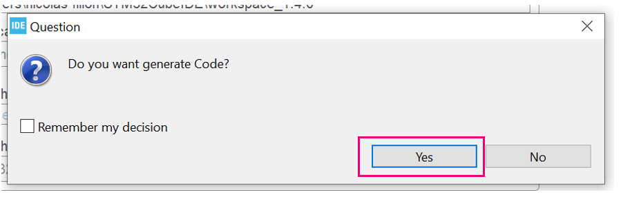

After this is done, the device configuration tool view is open in STM32CubeIDE. From here on, we can configure the MCU to be able to utilize the board's SD card slot.

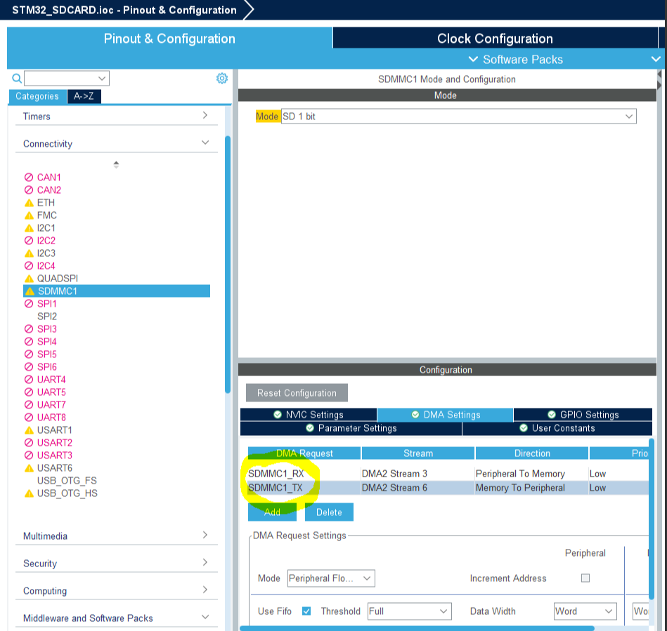

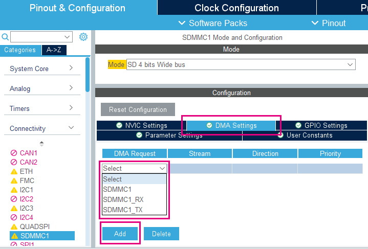

STM32 MCUs use the SDMMC peripheral to interface to an SD card, we need to configure it before we can write code that uses it. In this article, we also configure DMA access to the SDMMC peripheral to maximize performance.

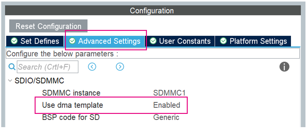

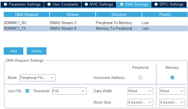

After adding these requests, the DMA settings panel should look like this:

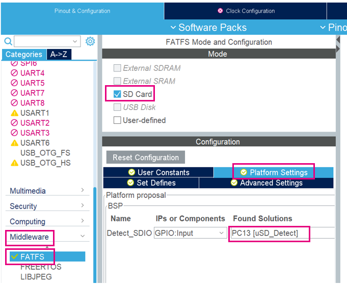

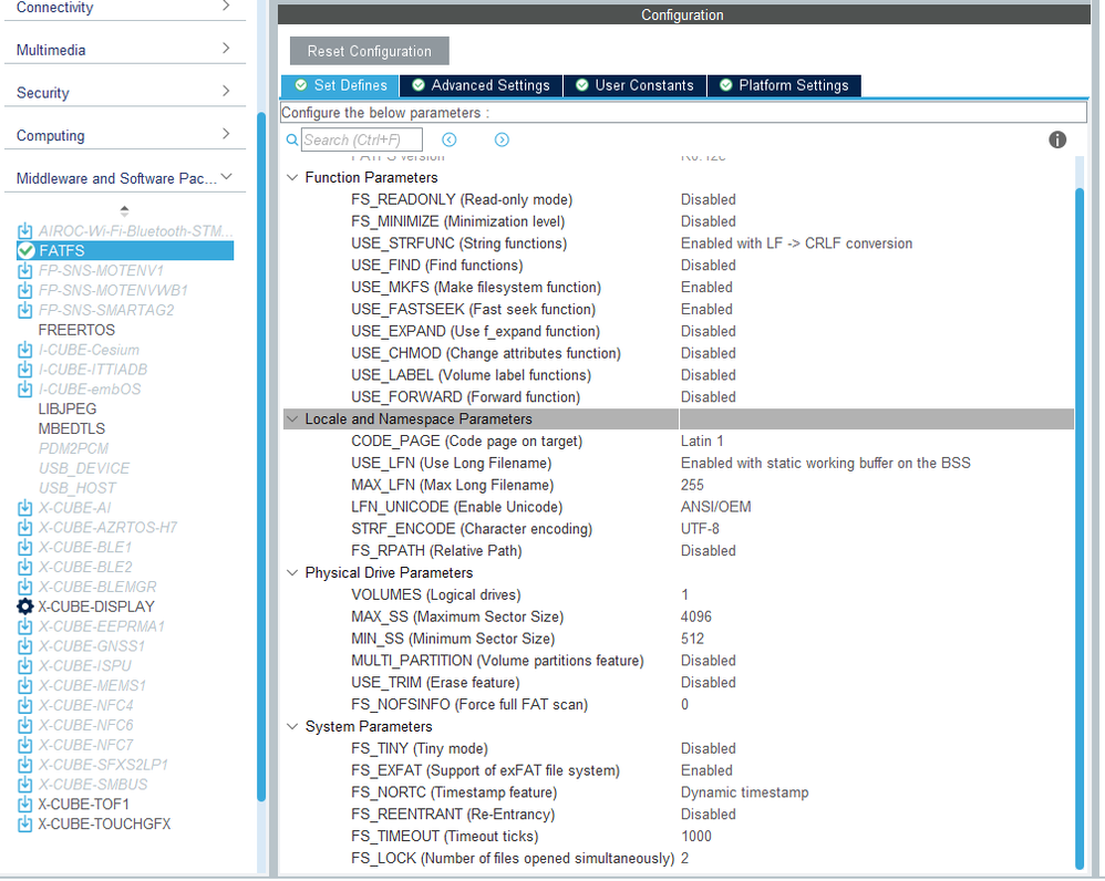

FatFs is an open-source file system middleware integrated in STM32Cube libraries. It is able to directly utilize the SDMMC peripheral to act as a disk device for the FAT file system. This is also configured through the Device Configuration Tool view.

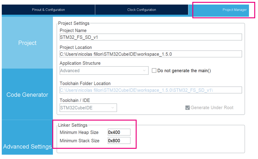

After the peripheral and middleware configuration is complete, we will also need to modify the clock configuration and certain project settings.

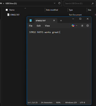

Finally, you may build the project and run it on the device by starting a debug session.
When the code is executed, the SD card is formatted and the text file is written to it. Inserting the SD card into a host PC, you may read the file, as presented in the screenshot to the right.

I'm using a different board and connector. My connector's detect switch is active high. I had to change this line of code in fatfs_platform.c from "RESET" to "SET".
if(HAL_GPIO_ReadPin(SD_DETECT_GPIO_PORT, SD_DETECT_PIN) != GPIO_PIN_SET)
This has to be changed to set anytime the ioc file is updated.

Like others it failed at f_mkfs. I watched the video for this guide...
https://www.youtube.com/watch?v=I9KDN1o6924
...and there is a step missing from this written guide. The missing step, as shown in the video, is to add the DMA Rx and Tx..
Since adding the dma rx/tx and changing the SD mode from 4 bit wide to 1 bit, it now works.
For some reason it does not work in SD mode 4 bit wide
I had the same problems. I couldn't not to get it working in 4bit mode but I got it working in 1 bit mode.
Actually when I tried older version of CubeMX the 4bit mode works. I think there is bug in latest CubeMX.

If you do not have PIN detect for SD card connected change this line change it in fatfs_platform.c

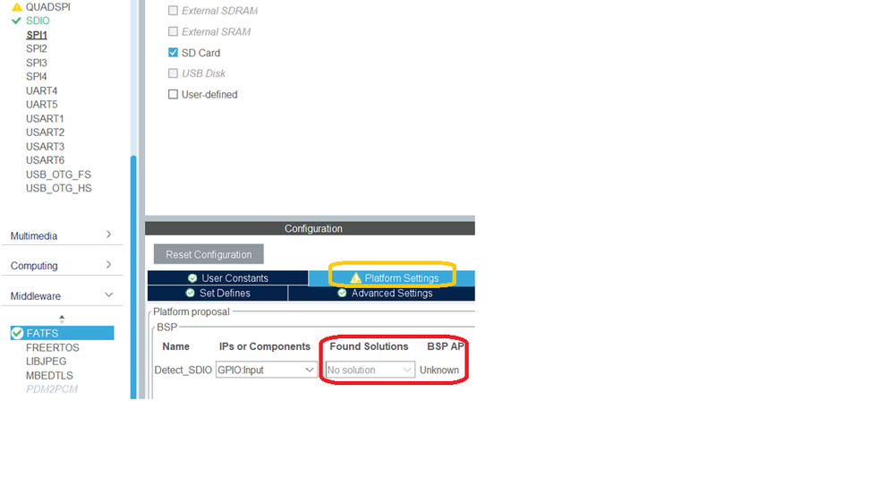

}As proposed here SDCARD does not work (FR_NOT_READY) when migrating from FW_F4 V1.27.0 to newer FW_F4 V1.27.1
I am using Nucleo-F446ZE board.
The Platform Settings at FATFS stage, the ioc editor cannot find solutions for Detect_SDIO option.
Can anyone give some advice on how to resolve it?
