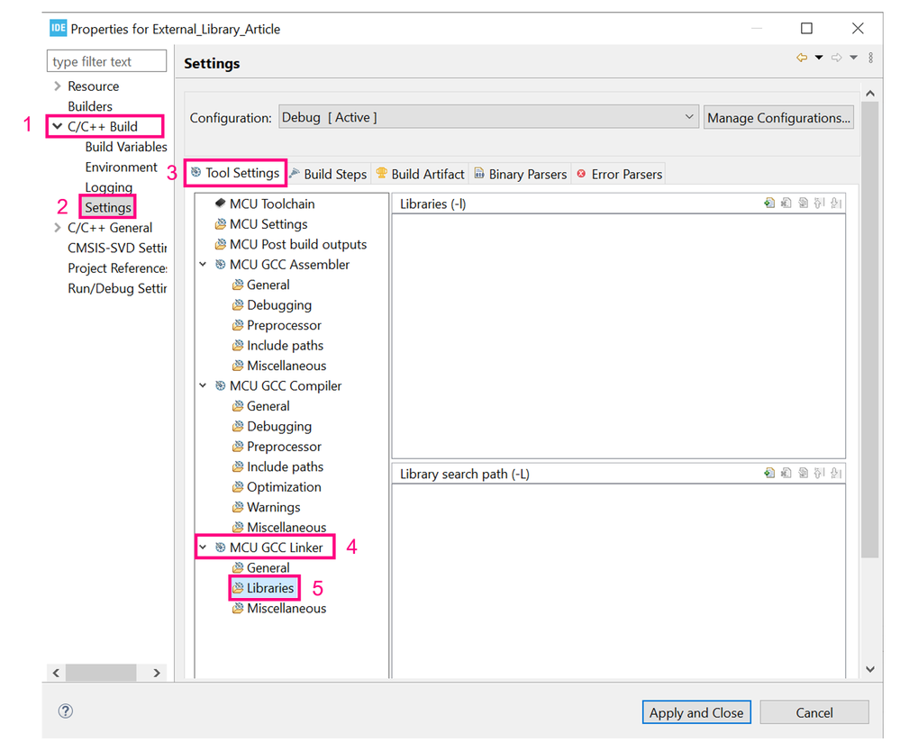

After creating a project for any chosen board, go to Project > Properties > C/C++ Build > Settings > Tool Settings > MCU GCC Linker > Libraries.

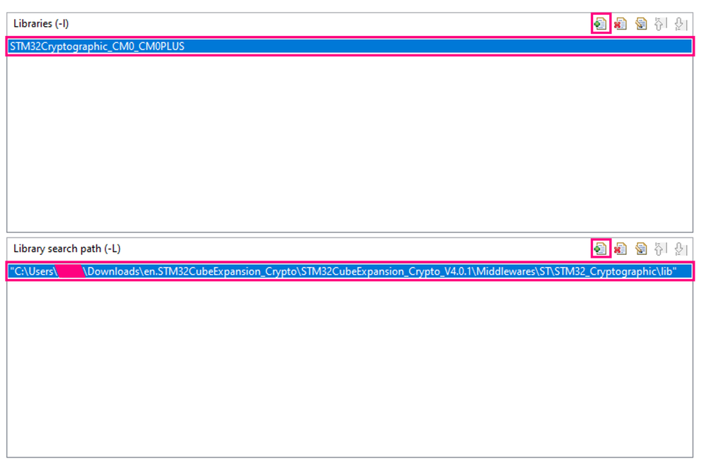

After following these steps, it is possible to add the library and its respective path like in the image below. When including the library name for statics libraries.a, it cannot contain the “lib” prefix and the extension “.a”. For the library added in this example “libSTM32Cryptographic_CM0_CM0PLUS.a" the library name at STM32CubeIDE is “STM32Cryptographic_CM0_CM0PLUS.”

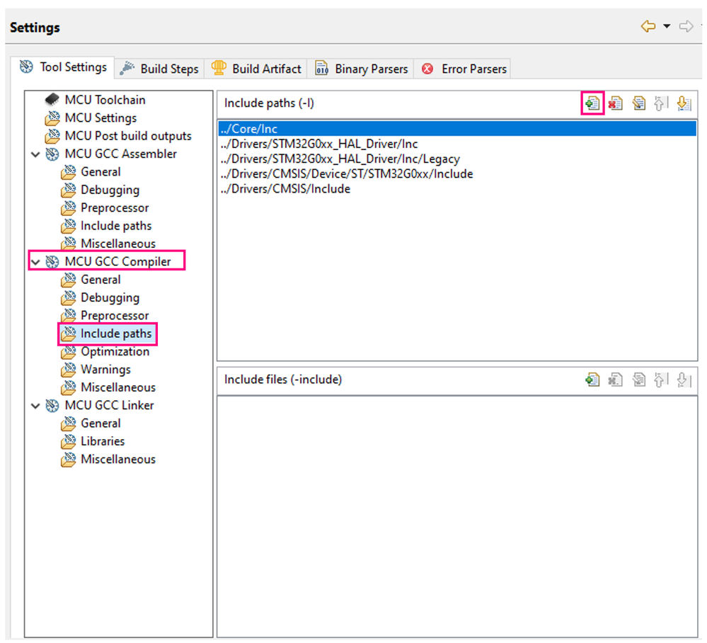

Now that the external library is linked to the project, the header file can be included by doing the following: Navigate to Project -> Properties -> C/C++ Build -> Settings -> Tool Settings -> MCU GCC Compiler. Include paths, and then add the path to the header file.

There is another way to add the library STM32Cryptographic_CM0_CM0PLUS by starting with ":" and using the filename (the X-CUBE-CRYPTOLIB examples use this method):
:libSTM32Cryptographic_CM0_CM0PLUS.a
For search path, quotation mark is optional when using slash instead of backslash.
If the Middlewares is copied into the project folder, relative path can be used like this:
../Middlewares/ST/STM32_Cryptographic/lib
"..\Middlewares\ST\STM32_Cryptographic\lib"
