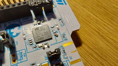

With RFD seems to me that error happen more often, and earlier after power up. Also seems kind of temperature dependent. But i have no relevant data. Could it be problem of first silicon version? After shield remove i found my Nucleo-WB55 is one from the first pieces populated with ES32WB55.

‎2024-01-09 4:04 AM
Hello Slavomir,
Actually the nucleo board you are using is among the first development based on the ES32WB55 which is a very early sample of STM32WB product not fully validated and may have some issues corrected in the final STM32WB devices delivered on the market.
I recommend highly to acquire the latest version of the nucleo board that may resolve your issue, if not, a sniffer logs would be appreciated to analyze the radio environment as I'm not able to reproduce the issue with a WB55 coordinator.
Best regards,
Ouadi
‎2024-01-09 5:59 AM
Hi Ouadi,
thanks you for your help. I'll buy new nucleo. I should check version of the device earlier. For now we can close this case. Again, thank you.
