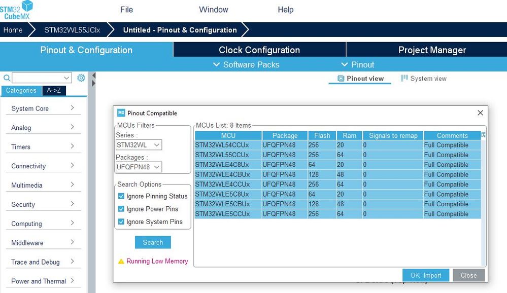

I'd like to use the Nucleo example with a different MCU. Is there an built-in tool for this?
Yes, I confirm if you are using the Dual core for the STM32WL Series: the Import from and to Dual core is not working in the release V6.2.1 of CubeMX.

Hello @bblouin​ ,
You can use the "List Pinout Compatible MCUs" feature in STM32CubeMX tool to find compatible devices for your MCU, and then you can import it.
I advise you to follow this FAQ that answers your question.
You can also use the Import project feature that appears under the File.
Please refer to the STM32CubeMX User Manual, for more details about the Import project feature.

• Import from and to dual-core is not working for the STM32WL Series.
• For dual-core products, IPCC LL + RF middleware (LoRaWAN®, Sigfox™ and SubGHZ_Phy) is not supported.
