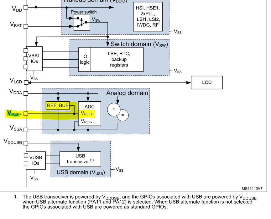

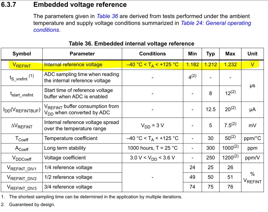

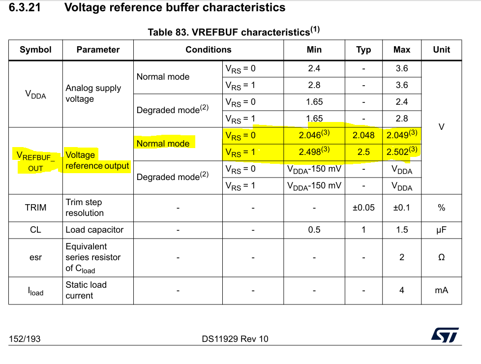

What is the value of the internal reference voltage of STM32WB55RGV6 MCU?
Is it 1,212 V or 2,048 / 2,5 V?

VREFINT is an internal reference voltage. It can get connected to some ADC input. REF_BUF when used is connected to the ADC VREF input.

Voltage reference buffer and Embedded voltage reference are different devices.
Do you mean these are two different sources of ADC reference voltage?
Uwe Bonnes
Principal III
