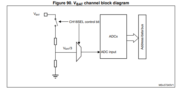

I am updating a PCB design that uses STM32WB35XX series microcontroller and 3 V CR2032 coin cell battery. I want to monitor the voltage level of this battery using the VBAT pin of the microcontroller. I know that is possible as specified in the picture below which is a snapshot from RM0434 reference manual of the microcontroller.Can I connect the positive terminal of the battery to VBAT pin directly for this purpose or do I need additional circuitry for connecting battery to VBAT pin?

use 3,3V VDD ? then need nothing, because vdd - 0,6 = 2,7 . so injection may be, if batt is 2,7 or lower - and that is empty/dead batt anyway.
just use ch18 only for test and switch off after testing, otherwise you kill batt by permanent test current.
‎2022-11-10 3:28 PM
Yes, you can do this, provided the battery doesn't exceed the pin voltage limits. If you're running the chip directly from the battery, there is no issue.
