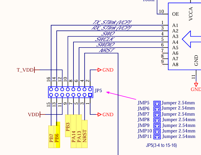

Hi everyone !
I'm really new to STM32 and everything that goes around... I want to communicate with a SIMCOM A7670E with my NucleoWB55RG and UART1. I'm using PB6 and PB7 for USART1_TX and USART1_RX. But these pins (I kept the jumpers) are also connected to TX_STlink and RX_STlink right? That's why I can print on a tera term terminal what is happening on the UART right? (I followed a tutorial with no explenations that's why I'm not sure).
My question is : is it a problem if I connect PB6 and PB7 on RX and TX of my 4G module? Maybe it will cause a conflict?
Thanks a lot!

You're going to have to make choices..
Can you use SWV/SWO ITM_SendChar() for diagnostic output?
Or find some other free UART-TX pin you can wire over to the ST-LINK output channel?
Go through the pin mapping options in the Datasheet, enumerate the pins available to you
https://www.st.com/resource/en/datasheet/stm32wb55rg.pdf
For example
PB5 LPUART1_TX
PA2 LPUART1_TX
PB11 LPUART1_TX
PC1 LPUART1_TX
Andrew Neil
Yes, it will cause a conflict.
You will be shorting your 4G module's TX output with the ST-Link's TX output - that will not end well.
As @Tesla DeLorean said, you need to consider options:
  • Disconnect UART1 from the ST-Lik, and move your debug IO to SWV/SWO instead;
  • Use a different UART for the 4G module.
