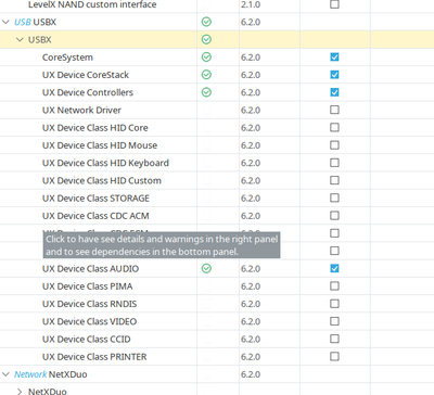

On CubeMX v6.14.1 and X-CUBE-AZRTOS-WB v6.2.0, I am not able to add a USB record/playback device.
This means that I cannot generate USB Device descriptors using CubeMX.
Why is this not possible yet? What are the alternatives?

We only deliver BLE Audio sample applications on bare-metal. If you are looking for a ThreadX sample application that uses USBX, you can use the Ux_Device_CDC_ACM app for NUCLEO-WBA65RI in the STM32CubeWBA firmware release. You can also find a FreeRTOS BLE example for NUCLEO-WBA55CG on GitHub Hotspot if you prefer another OS: https://github.com/stm32-hotspot/STM32WBA-BLE-HeartRate-FreeRTOS.

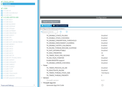

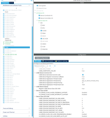

Hi @FBL,
Thank you for your response!
Is it not possible to add ThreadX using CubeMX anymore for STM32WBA6?
Even when I select manually, I do not see a recording or playback option.
An option to select ThreadX is grayed out. What is your suggestion regrading manually selecting AzureRTOS version? It is not clear to me.
May I ask why I cannot use X-CUBE-AZRTOS-WB here? Can you guide me on the workflow for WBA6 please?

Hi @NRedd.2,
A new GitHub Hotspot repository containing a USB Audio examples with USBX in standalone mode (without Azure RTOS) using the STM32WBA6 is currently under validation and should be released in a few weeks. It will include:
  • A USB Audio Playback project on STM32WBA65I-DK1, which plays audio from a USB host on the discovery kit's jack output
  • A USB Audio + BLE Auracast project on STM32WBA65I-DK1 and NUCLEO-WBA65RI, which plays audio from a USB host on a Bluetooth Auracast stream
Although it will not contain any USB Audio Record examples, you should be able to use these projects' USB descriptors as a base to build your own application.
