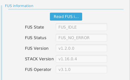

2023-04-21 1:59 AM - edited 2023-11-20 8:20 AM
Reading the FUS information gives the following results:
Trying to install the following wireless coprocessor binaries give me the anti-rollback error message:

10:29:23 : Time elapsed during the read operation is: 00:00:00.000Is there any solution to allow the installation of those other binaries?
Can stm32wb5x_BLE_Stack_full_fw.bin be used to replace stm32wb5x_BLE_Thread_dynamic_fw.bin?
Best Regards
2023-04-26 9:21 AM
The version of BLE Full stack (stm32wb5x_BLE_Stack_full_fw.bin) is v1.16.0.4. The version of Thread FTD stack (stm32wb5x_Thread_FTD_fw.bin) and BLE Thread dynamic stack (stm32wb5x_BLE_Thread_dynamic_fw.bin
) are v1.16.0.0. That's why in your case, you can't change the wireless stack from BLE Full stack to Thread FTD or BLE Thread dynamic stack. So, the only solution is to wait the next STM32CubeWB release v1.17.0 or to buy another board.
You can't replace stm32wb5x_BLE_Thread_dynamic_fw.bin by stm32wb5x_BLE_Stack_full_fw.bin.
