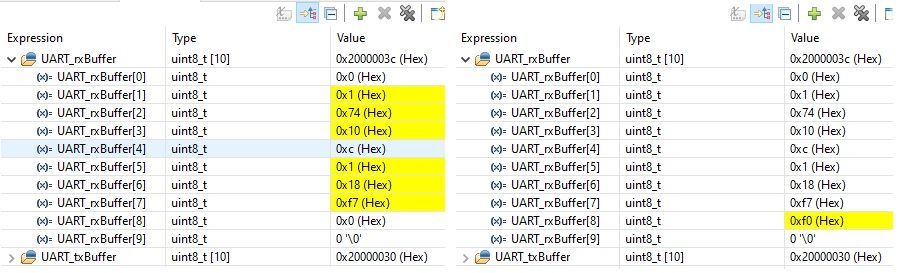

However, I now, of course, have a different issue. It seems to be missing the first byte. I am receiving all the data as expected (00 01 74 10 0C CH CS F7), but I'm missing the F0 at the beginning. When I run it a second time, it would appear the first byte of the new command is in the final byte (8) of the previous command and that first byte is missing in the next set of values as well (see screenshot attached).
I tried reading the data one byte at a time (shown by the commented out section in the interrupt function) but got a similar result.

‎2020-11-22 9:54 PM
