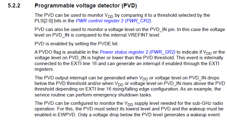

We are investigating. Note anyway that a more accurate and more power-efficient way to detect voltage to enable or not sub-Ghz radio is to use the PVD feature.
Please look at chapter 5.2.2 of RM0461

Minor addendum, further tests on the MCU in our possession have shown that:
  • the EOL flag behaves in the opposite manner as shown in the datasheet (ie: the flag is 0 while the supply voltage is below the radio end of life operating low level rather than 1 as it is written in the datasheet)
  • in a test using a pair of partially discharged AA batteries, both the PVD (level 0) and the EOL flag indicated that supply voltage was sufficient to operate the radio safely. However when the join procedure was initiated, the current drain was large enough to cause the voltage to dip below the threshold level for BOR level 0 and thus cause a reset of the MCU

Thank you for your investigations.
We confirm this feature works properly but there is indeed an error in the user manual as you state it.
We will correct it in the next release.
