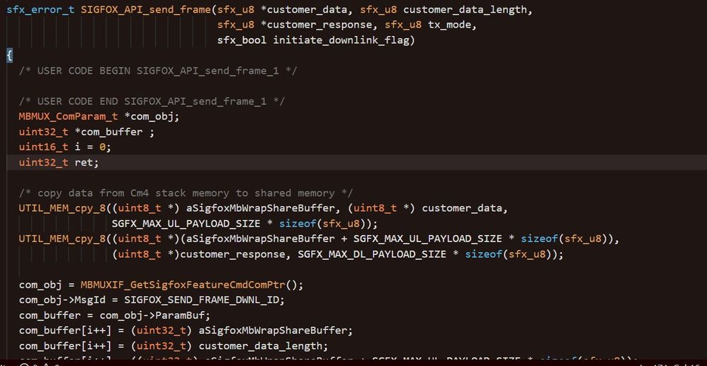

So I tried to run the code but no signal from Sigfox came out. I was confused by not having a prototype like the dual core version has. As shown in the figures below.0693W00000DqDyjQAF.jpg
Here we can see the prototype of the SIGFOX_API_send_frame() function. But this only exists in the dual core example. The single core has no prototype of this function, and I don't see any signal coming out of the board when I run the AT_SLAVE or PUSHBUTTON (SINGLE CORE) example
