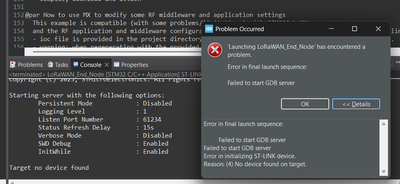

I'm trying to flash the example program in B-WL5M-SUBG1 connectivity expansion board, and below issue.
Tried with different EVK boards but still the persists.

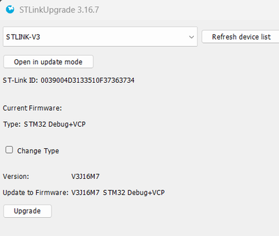

I got a popup for updating firmware of STLINK-V3MINIE debugger, so I upgraded the firmware from V3J8M3 to version V3J16M7 before flashing the hardware.
Above is the screenshot taken after the firmware upgrade.

Hello @PrakashN
Could you please try using the STM32CubeProg V2.19.0 or the STM32CubeIDE V1.18.1. If you still have issue, please describe the connection and the HW setup of both ST-LINK and B-WL5M-SUBG1.
