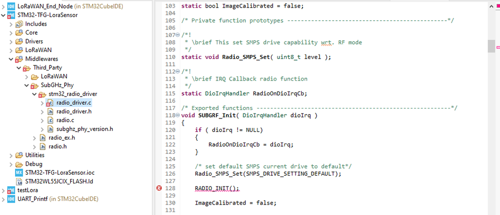

STM32WL55JC undefined reference to `MX_SUBGHZ_Init' its STM32 Cube MX generated code and giving this error.
RGili.1
If I click in the error it navigates me to #define RADIO_INIT               MX_SUBGHZ_Init, but no function is created by CubeMX.
Hello @RGili.1​
You need to disable the MX_Subghz_init function visibility ( under Project Manager - Advanced Settings ) to avoid this error.
Please re-check and tell me if problem was solved or not.
Thanks, Khouloud

RGili.1
Yes, using updated versions
Cube IDE Version: 1.6.0
CubeMX Version: 6.2.0-RC3
Hello @RGili.1​
Thanks, Khouloud
RGili.1
Yes, problem solved disabling MX_Subghz_init function visibility.
Thank you!
