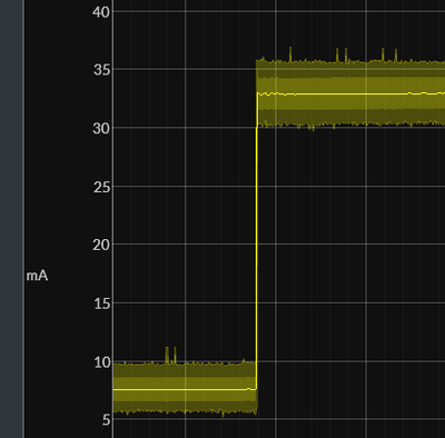

On our current hardware, I am noticing a large jump in current draw at the function call for __HAL_RCC_USB_OTG_HS_PHY_CLK_ENABLE() in HAL_PCD_MspInit().
Just prior to the function call, the board is drawing 7.5mA, and immediately following the call it is drawing 33.09mA.

  • Here's the measurement as I step over the function call __HAL_RCC_USB_OTG_HS_PHY_CLK_ENABLE() in HAL_PCD_MspInit():

We did some additional testing over the weekend and it seems that an inefficient inductor value was chosen for our boards. The end result was that if we were pulling 5mA for VDDUSB and 8mA on 1.8V VDD, we were drawing 32mA from the battery. We are continuing to test to confirm this.
