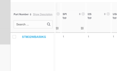

STM32WBA50KG I2S Function Pinout
‎2024-11-13 12:16 PM
The product page shows that the STM32WBA50KG supports I2S for a serial audio interface. I want to connect a Class-D Amp and cannot find any reference to I2S or SAI in the data sheet or programmers reference manual. Does the processor support I2S?

Hello @JimRVLock
As you can see on the top of the page 1646 of the RM0493 Rev 5, the SAI is Available only on STM32WBA54/55xx devices. So, the STM32WBA50KG does not support the SAI/I2S.

‎2024-11-14 9:11 AM
Understood and I upgraded to the STMWBA54.
Just to be clear, the data in the product selector is wrong and should be corrected at some point, but it's not a problem at this point {see below screen shot}.
Thank you for the information and quick response to my question.
