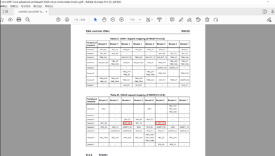

I found the DMA request mapping of the F4 series on ST's official website. With this form, I can configure DMA on zephyr.
My problem is that I cannot find the DMA request mapping of STM32WBA52CG. Can you provide me with one? Thank you.

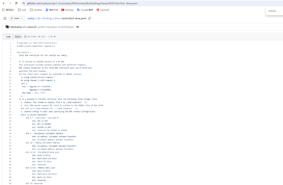

The device tree file requires channel and request parameters.

the table may like this which belongs to F4 series.
