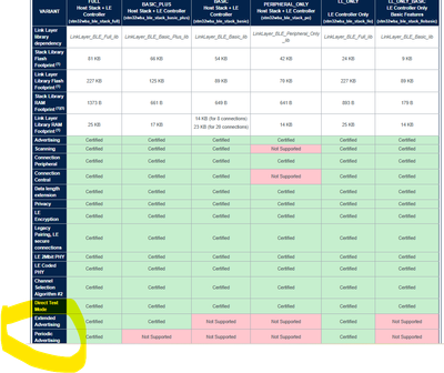

dxxx0001
What about WBA65?
Also, stack is certified with PAwR?
https://wiki.st.com/stm32mcu/wiki/Connectivity:STM32WBA_BLE_Stack_Integration
It will do Periodic Advertising (5.0). It will not do Periodic Advertising with Responses(5.4). It will do Encrypted Advertising Data (5.4). This lets ST claim BLE 5.4 "qualified".
