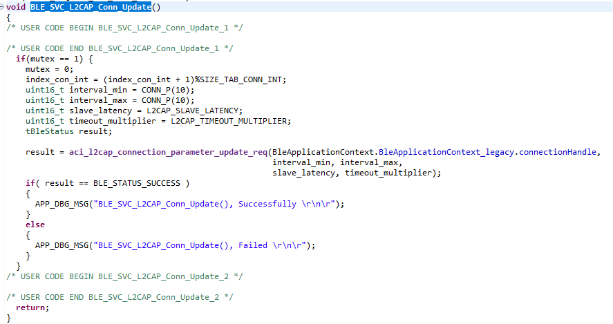

You can change the connection interval using aci_l2cap_connection_parameter_update_req command, you can look BLE_p2pServer example which allow to change connection interval by pressing SW2.

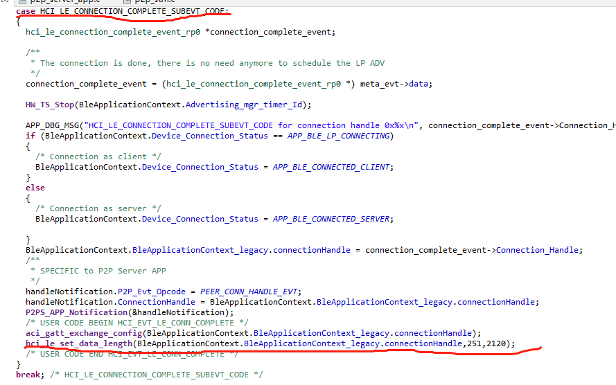

Thank you. I changed the interval only when I added the command hci_le_set_data_length().
Why is this, I see that the ble server does not use this api.

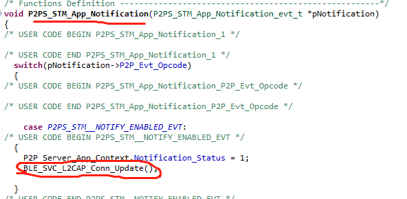

0693W00000VOPDWQA5.pngBLE_SVC_L2CAP_Conn_Update() as picture:
