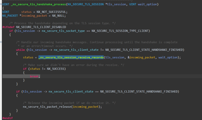

Hi
I'm trying to setup TLSv1.3 using STM32H63 Nucleo board. I followed the steps in https://github.com/eclipse-threadx/rtos-docs/blob/main/rtos-docs/netx-duo/netx-duo-secure-tls/chapter3.md to enable TLSv1.3 in STM32CubeMX. But all I get from the OpenSSL server is:
ssl.SSLError: [SSL: NO_SUITABLE_SIGNATURE_ALGORITHM] no suitable signature algorithm (_ssl.c:1006)
How do I solve this? I checked with the debugger and I can see that this code gets hit
#if (NX_SECURE_TLS_TLS_1_3_ENABLED)
    if(tls_session->nx_secure_tls_1_3)
        /* Send supported TLS versions extensions (for TLS 1.3). */
        status = _nx_secure_tls_send_clienthello_supported_versions_extension(tls_session, packet_buffer, &length, &extension_length, available_size);
        if(status != NX_SUCCESS)
            return(status);
Using wireshark I can see that clienthello from the client

which results in a handshake failure

CONNECTION CLOSEDWhile debugging I can see this
With status values of 0x20007.

2024-09-19 5:00 AM
Status value 0x20007 could be NX_CRYPTO_PTR_ERROR defined in nx_crypto_const.h.
It looks like an incorrect netxduo configuration in the code running on the STM32.
How is the memory allocated ? is there enough memory for a TLS network stack ?
It's difficult to understand the root cause without the full project sources you are using.
Did you modify an example provided in Cube H5 package ? (Nx_IPerf, NX_UDP_echo_client, ...)
The full ServerHello packet details from wireshark , and the full openssl s_server trace (with -trace option) could help.
